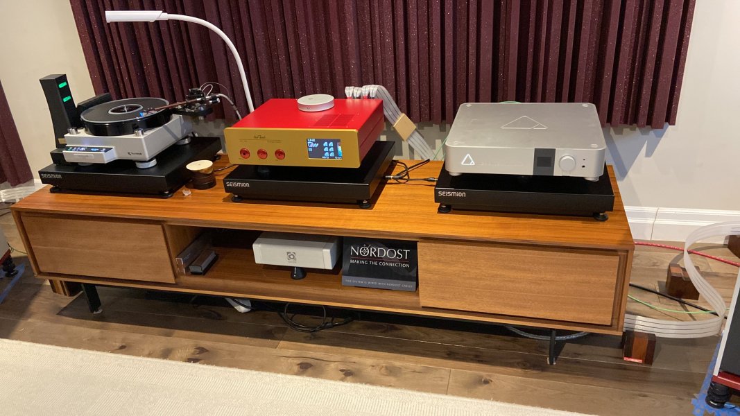

The Seismion products are available to the North American market from Sonic Artistry, Toronto Canada, www.sonicartistry.ca . We have just received our first units with a number more on order. We will be presenting and showing at the Montreal Audio Fest this coming March 22 to 26 in room 2333. We will be using the Seismion 54's under the darTZeel LHC-208 mkII and Merging NADAC + Player at the show.
The Reactio model 54 (500x400mm) $5,650 USD, and the Reactio model 65 (600x500mm) $6,900 USD. That includes shipping door to door, brokerage, importation tax. LOCAL taxes (ie state taxes are by the individual if the state comes after you for them). Canadian Pricing is $7,600 and $9,300 CDN respectively.
