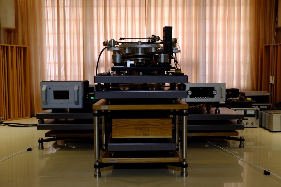

This is a happy user of Transrotor on Seismion.

Regarding the question of application of Seismion Reactio under the turntable, I can share my personal experience.
I have just received my Reaction this week and tried it under both the tube preamp (Audio Research R6Se) and the non-suspended turntable (Transrotor Apollon). I found it provide more sonic improvement under the turntable!
It works extremely well in combine with my original anti-vibration platform, composed of multi-layered audiophile platforms and footers of different materials, for turntable. After implantation of Reaction in my system, more details are easily discernible and sound image is more solid and 3D, just like the real instrument playing in the audio room. The loudspeaker sound more effortlessly and provide wider range of dynamic and fast transition. In addition, the depth of sound stage and image focus are also improved. No negative sonic effect is found!

There is no CMS platform in my system so I am afraid I cannot compare with Reactio.
The gray platforms are TAOC platforms, made of MDF and cast iron. The price is a bargain for audiophile but it functions very well while you couple with the appropriate footers beneath.
The footers and platforms used under the Reactio follow as
MYSTJ ceramic footer, BDR carbon platform, BDR cone, TAOC platform, Isoacoustics GAIA, TAOC platform, BDR plate and MYSTJ ceramic footer.
And all the system is placed on the MYSTJ RXEX rack.

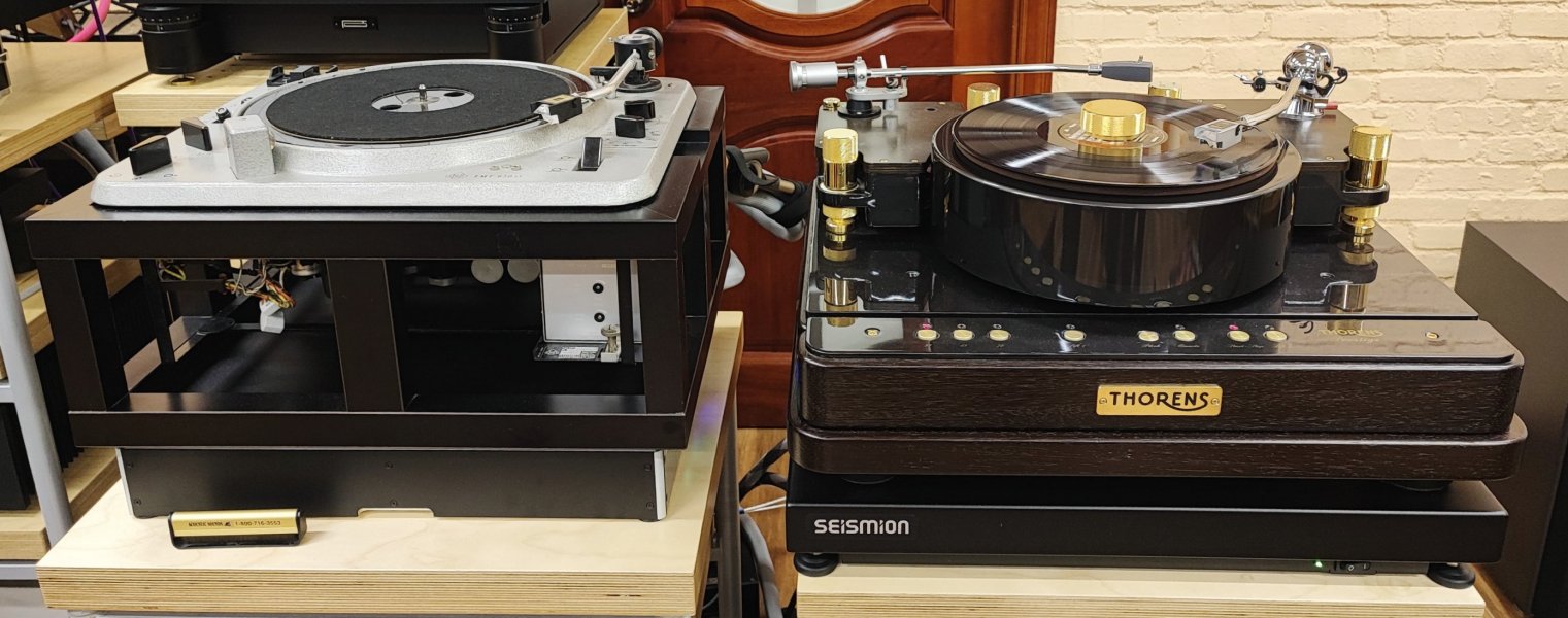

I visited a good friend yesterday.
He had both Accurion and Seismion, for his two turntables.
We didn't have time to compare the effect of both anti-vibration platforms on the two turntables but he had done that already.
He is a very experienced audiophile and is very meticulous.
The above combination suits his audio system and taste very well.
I don't think Seimions/Accurion/Herzan are not suitable for "floating/soft" types of turntables.
The Thorens with Seismion is heavenly!
