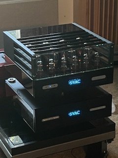

Florian can I take the liberty to add one to your statistics? Auditorium> 225wpc VAC Statement 450S iQ
Stereo (discontinued I believe). Thank you again for your invaluable assistance.
