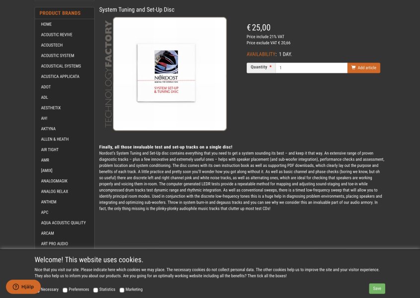

I have been following this tread. I have looked around on the Internet for a LDEAR checkup. CD or a download but not sure that I found the right product. Any recommendation?
You can find the LEDR tests, plus a bunch of other useful stuff, on the Nordost System Solution test and set-up discs. I'm not aware of anywhere that they are available as a download.
Reactions: Gunnar
Thanks I found it.
My “listening room” is a little bit complicated. Will buy it and see what’s coming out.
