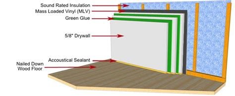

What is an MLV application?

Mass Loaded Vinyl. They can hang these heavy sheets to drape the studs. Used for soundproofing (not your target need), but for energy control too. Your acoustic person will have an opinion, I'm sure. The catch will be shipping, if no source near you: it is heavy! However you go, it'll be fun!
