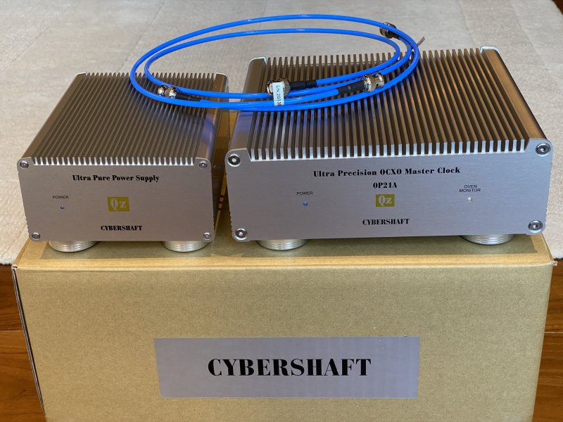

Just arrived... my Cybershaft OP21A-D and LTPW-01 - thanks again to TLi who so kindly brought his unit for me to conduct a home demo, which converted me from a healthy skeptic to a feverish advocate ! Eagerly looking forward to connecting the 10MHz sinewave clock outputs to my three SOtM devices, as well as my Aurender W20 (whose performance with the Master Clock signal has not been ascertained yet). I also feel doubly lucky for perhaps having grabbed one of the last OP21As before production resumes again, due to supply constraint issues.
According to plasmod3:
Reactions: TLi
