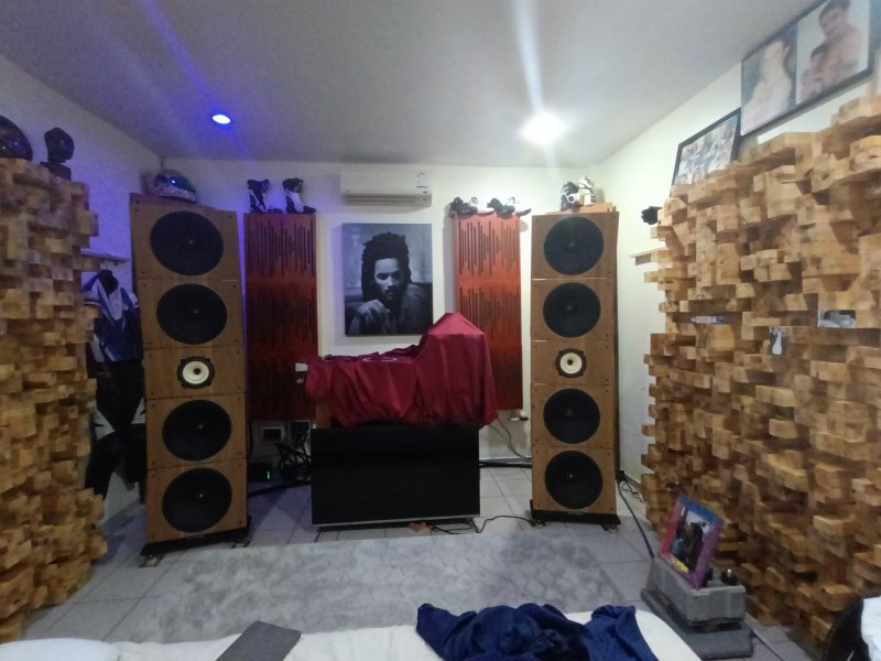

So I am finally very close to my ideal balance of sound. What I have struggled with is the in-room response between the 4 x bass drivers and the Coax that handles the mids and treble range. I have completed all the crossover parts upgrades and adjustments so this last stage is the icing on the cake.
I was really wanting to get a bit more mid and treble gain. The bass is a bit too good. After adding the big Solen Air-Core, the bass has increased in both detail, speed and gain, odd as the Solen has slightly more resistance, but must have zero saturation and more energy transfer? It is not much gain, but is there and affecting the overall FR.
Then I remembered, way back when I configured the room layout, I played a lot with distance from the back wall and TOE IN. I found tiny adjustments of toe in affected the bass energy a LOT. So last night I tried some different angles, very subtle, until I found my ideal in room response. BINGO, I think I have got it. No toe in = less bass, more toe in = more bass, to the point you can cut the bass gain by around 30%!!
The fact the PAPs are open backed means the amount of rear firing energy and how much of that comes back to the front is directly affected by toe in.
With my latest adjustments, I have got the Coax driver come come through more, but not lost any bass extension or drive, rather attenuated the volume of the bass. Manically playing many test tracks I found it is now superbly balanced and detailed right across the full FR. I am at about 10° toe in.
No doubt I will try tiny adjustments to toe in going forward, but right now it is a superb result, and has resolved my in room issue.
Damb, these speakers are so good, I would HIGHLY recommend anyone to take the PAP route, open backed is where it's at IMO. And on a budget. Remarkable product.

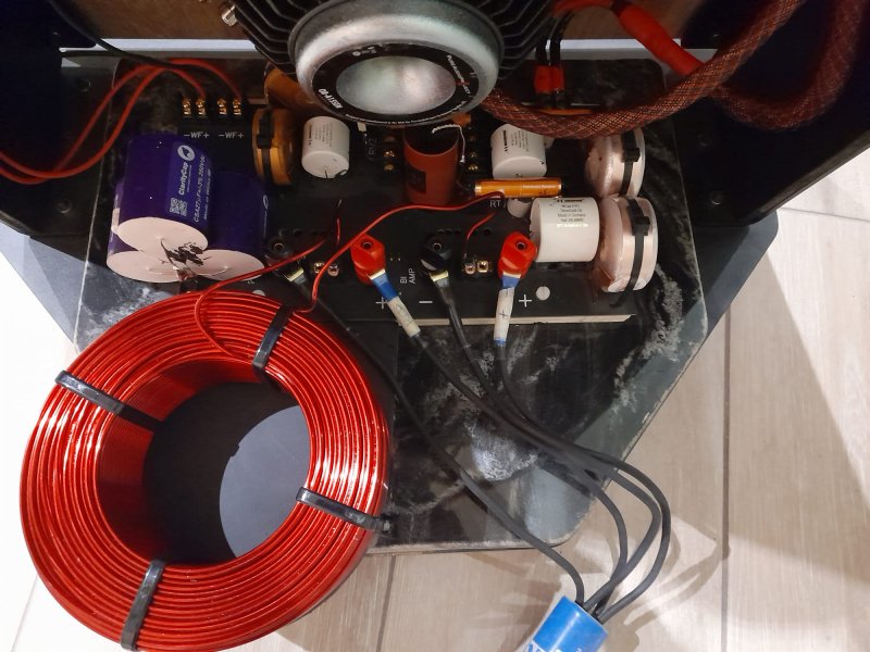

I was curious about the same thing. I tried to eliminate anything magnetic around the crossover, replaced the mounting screws with stainless steel screws, was especially worried about the metal screws around the foil coils as they were all most touching. I kind of address the wire against the magnet, used egg crate foam in between the wire and the magnet. Not sure how much this really helps, but figure it is better than being right up against the magnet especially because the wire I used was not shield.

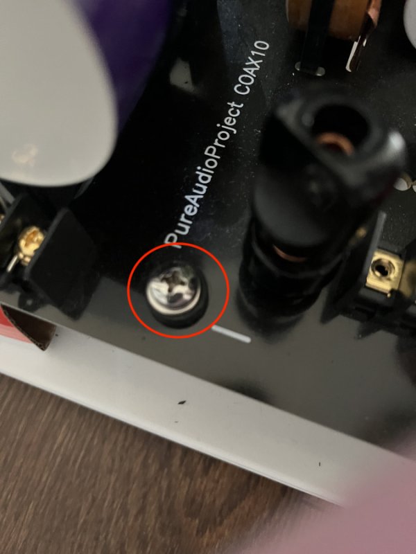

Can someone provide a link to the best isodamp material and source? I have the duet horns…..
I couldn’t find an isodamp washer….
Thank you!
Richard
Using Isodamp on the entire surface area where the baffle meets the frame adding washers so the bolts don't sink into the baffle is a big step up. Brought everything into focus tightened up the sound offering more detail from top to bottom. It was also the first and cheapest upgrade. Large impact.
Putting Isodamp on the back of the baffle is an interesting idea, I thought about putting some NoRez on there myself.

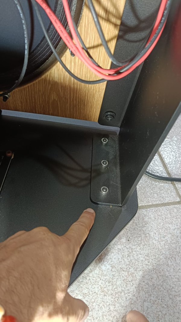

Bonjour à tous.
Tout d'abord, merci pour vos messages.
Cela vous aide à progresser et à vous sentir moins seul face à vos questions.
Je suis l'heureux propriétaire d'une paire de PAP Qunintet15 avec un Voxativ 1.6.
Mon souhait initial était d'acquérir le Voxativ AC-X, mais pour l'instant, j'ai dû composer avec mon budget pour m'offrir les Quintet15 neuves.
Peut-être plus tard…
J'avais une vibration dans l'une des Voxativ.
On m'a conseillé de déplacer le filtre.
Ce que j'ai fait. Je l'ai temporairement placé sur des morceaux de bois.
À ma grande surprise, j'ai constaté une légère amélioration du son en plus de ne plus avoir cette vibration.
J'ai fait une recherche en ligne et
je suis tombé sur votre forum, qui est super. Je reproche aux Quintet15 d'être moins détaillées en arrière-plan de la scène sonore que mes anciennes enceintes d'une autre marque. Sinon, les Quintet15 sont meilleures.
En lisant ce forum, je vois que certains d'entre vous ont remplacé les câbles d'alimentation des enceintes.
J'ai vu que vous parliez de trois types de câbles :
les câbles Fidelium
les câbles Mike Meltdown Powell
et les câbles Graditech.
Étant novice en PAP, c'est ma première enceinte de ce type. Pourriez-vous me conseiller sur les câbles ?
J'ai également lu qu'il était possible de construire un filtre.
Je ne suis pas fan des deux cavaliers, je pense qu'il y a moyen d'utiliser quelque chose de plus musical. Je vais voir ce que je peux essayer d'améliorer, sachant que je n'ai aucune connaissance en la matière.
Concernant les vibrations sur le cadre, j'avais envisagé de mettre des poids sur la base pour les limiter.
J'avais envisagé de placer les enceintes sur une grande planche de bois.
J'avais également envisagé de placer de la mousse isolante entre tous les éléments boulonnés du cadre pour limiter les vibrations.
En lisant vos messages, je vois que mes idées n'étaient pas très éloignées des vôtres.
Je vais également me pencher sur les rondelles et voir si je peux limiter les vibrations.
J'ai beaucoup d'idées d'amélioration, merci à vous tous.
Ma priorité sera de trouver un emplacement plus propre et plus efficace pour le filtre.
Ensuite, trouvez des câbles et, si possible, faites-les de même longueur.
J'envisagerai également de placer une épaisse planche de bois horizontalement entre le cadre, ce qui pourrait le renforcer et absorber les vibrations. Pourriez-vous me conseiller sur l'achat de câbles pour obtenir la meilleure qualité musicale ?
Et si vous avez d'autres conseils, n'hésitez pas à les consulter.
Merci.
Yann
