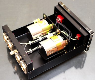

your cadenza is a neutral sounding mc. its resistance is 5 ohms so it is suitable for sut. For cartridge with a system impedance of less than 15 ohms, I would always go for a transmission ratio of 1:20. I would also recommend warmer sounding transformers,. I don't believe in switchable transformers because the signal voltage of the pick-up is small and switches can have contact problems over time. rather save the money for a second transformer. Then adapt it to the new other cartridge.
Exsample model audio note an s3/m 4-6 ohms(4000$
Cheaper silk audio mc220A 1:20
Exsample Pic switchable version

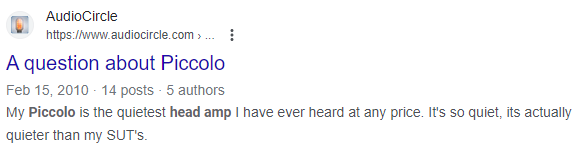

Actually, SUT do indeed add hiss. They are not silent because they are not resistance-free. I once had a relatively low cost SUT (commercial) that added more hiss than my active (Piccolo) headamp! Why? Because the magnet wire was so thin it added quite a bit of series resistance, which led to noise. Easily measured.
Try this, measure the series resistance of both primary and secondary. Do the math for equivalent ESR as seen by phono input. Now calculate added Johnson noise. Your SUT is not silent.
Meanwhile, my active headamp has independent loading and gain, and that makes matching virtually any MC cart a lot easier. Good for all MC carts simultaneously.
When it comes to noise floor, there is a point of diminishing returns. As long as electronic added noise is well below "silent" groove noise (while playing), then you're good. Improving electronic SNR will not improve the final application result.
For reference, my Piccolo is at 3nV per root Hz for noise. A 1k resistor comes in at 4nV per root Hz. Any SUT with a secondary winding resistance greater than 600 ohms will have a higher noise floor than a Piccolo. Easy to measure, folks.
