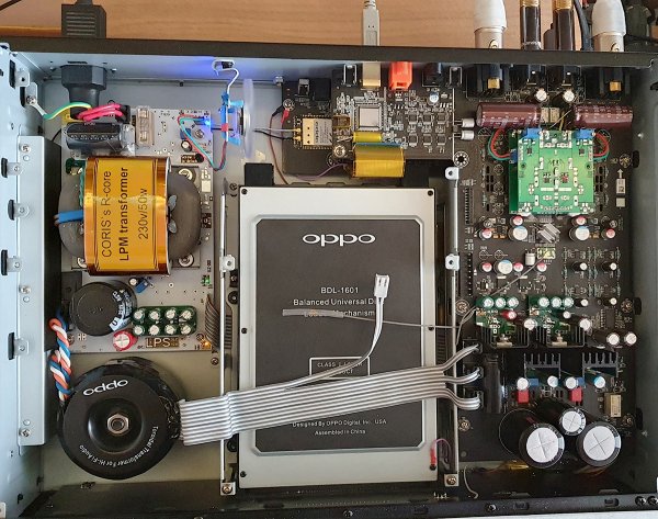

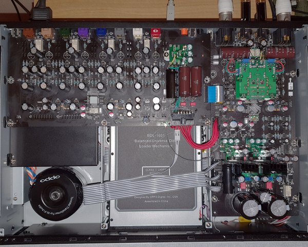

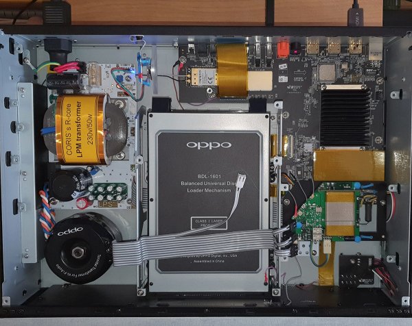

My latest version full upgrade for UDP205...

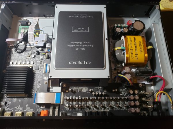

It's been a long time since anyone posted in this thread, but I recently moved back to 120V land and needed a new LPS for my 203. Decided it was time to go big and try out the Coris unit so I ordered one.
Transatlantic shipping is a nightmare these days as it takes forever. In the meantime I decided to pick up another ZeroZone LPS - this time the new higher model copper version. This allowed me to compare it to the Coris LPS to see if the large price difference is justified.
I used the ZeroZone LPS (with upgraded IEC and digital cable also from ZeroZone) for about a month before I received the Coris LPS. I swapped in the Coris LPS (which also required removing the upgraded IEC and digital cable) and put in Casino Royale UHD.
So was the Coris LPS better than the ZeroZone? Is the price justified? The first question is an unqualified yes - the noise floor dropped to unimaginable levels revealing a wealth of background effects that I never knew existed until then. There were also clear improvements in vocal intelligibility and treble smoothness versus the ZeroZone. Is the Coris LPS worth double the price of the ZeroZone LPS. To me, yes, but I can't deny that an LPS that costs as much as the retail price of the player is a tough sell. However, if you're willing to spend the cash I can't imagine how anyone would be anything less than thrilled with the Coris LPS. Having said that, if the Coris LPS isn't in your budget please pickup the ZeroZone LPS or other quality LPS - this is the single biggest and most rewarding improvement you can make to your Oppo 203.
