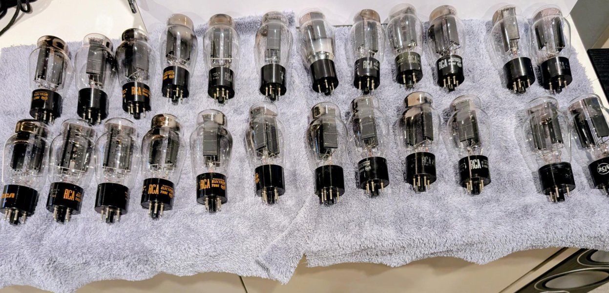

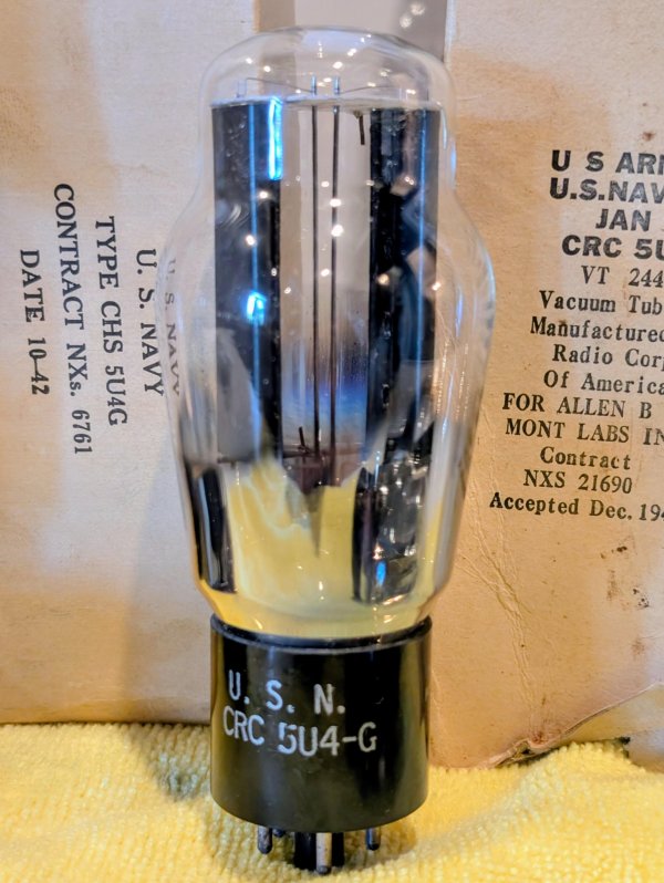

My collecting was more by accident than seeking rare tubes. My phono stage and amps use 12AX7, 6SL7, 6SN7, 6CA7, 6922, 5U4G, 6BL7, EL34, WE-300B, 845, and KR-1610 tubes. When the phono stage is running and speakers are bi-amped, there are 60 tubes in use. The phono stage and its power supplies use 24 12AX7s. When I got into tube gear 30 years ago, I quickly figured that I needed a lifetime supply since some of those tubes were not in production at that time. While supplies have come and gone over the years, some of the most preferable sound (to my ears) come from NOS tubes. As I did more investigation into reliable sources and tube dealers, I found some pretty nice sets of tubes.
I really enjoy your posts and photos. Keep them coming!

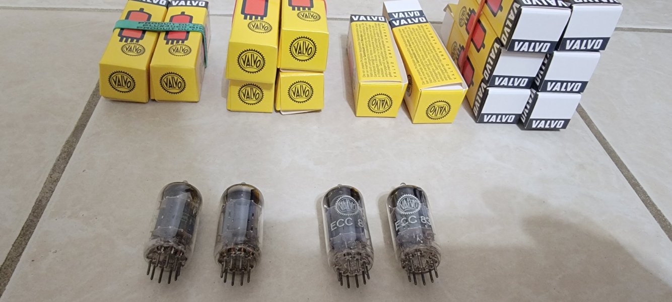

What are your favorite tubes to mix with CSF? Have you ever tried CSF with Valvo?
When I usually combine french tubes in output stage I prefer to put something more clean and resolving in the input stage. So I usually put Siemens/Telefunken production. Valvo for me is more tubey and might not get well with the french romantic sound. Same for the british tubes like Mullard. I cannot say that a specific combination always works, it is more a repetitive trial and error for me. During the years I learned the strengths and weaknesses of my tubes and when I hear what is missing, I usually know what I have to change. But since I listen to modern music, so I rotate between different albums or maybe add new titles to my playlist, I often reach the point that a specific combination is not perfect for everything, so I have to tune also album dependant.
Sorry for a less exact answer, but this is how I deal with tubes.
PS. From my memory, I also used Brimar tubes successfully with some CSF/SFR/RTC tubes.
