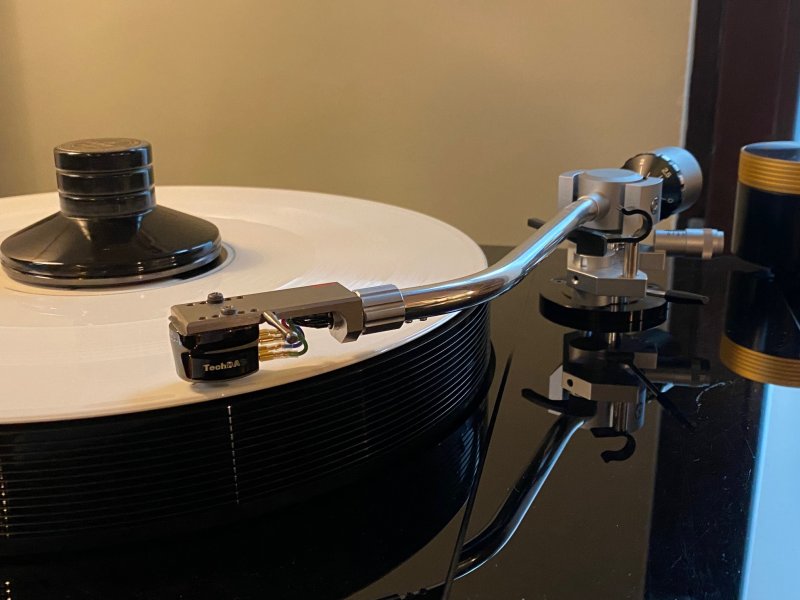

My work horse to compare Carts is the TechDAS AF3P , the most of my other turntables are for collector purposes, like DQX 1000.

Before I start comparing Carts, my set up must be tuned to play "neutral". For this purpose I prefer digital with less variables as a striating point. The set up must sound in balance, even when playing music from Tidal. I have often visitors and I do visit other people to listen to their gear. I tend to have, as a matter of personal taste , a little leaner bass and a more neutral (not warm) higher frequency voicing.
My speakers are like 2.5 to 3 meter from every wall, listening distance is nearly 6 meter.Listening position is nearly 2 meter from the rear wall.
Moving over to analoge, I do use the AMG Viella turntable, AMG 12J turntable and the AMG Teatro cartridge on the AMG/HRS M3X platform.
This analog "out of one manufacturer hand" set up should sound similar in tonal balance to my digital set up.
The AF3P has in overall a better performance as the AMG,
so the TechDAS turntable should show this with all compared combinations in competition to the AMG,
which is my "reference point"
