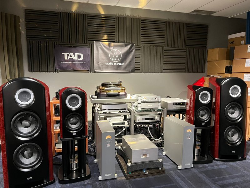

Recently I had the chance to listen to Nagra HD pre + HD power driving TAD R1-TX. The HD pre is equipped with the optional transformer-XLR. Front end was TAD D600. I have listened TAD C600+M700S in this setup multiple times and pretty familiar with the sound.
To my ear, Nagra combo delivered an extended yet delicate highs. Macro and microdynamic were good with plenty of resolution. The mid was opened and spread across the soundstage. The low end lacks the grip of TAD combo though.
However I am not too convinced that Nagra HD pre-power combo is better than TAD pre-power combo driving TAD R1. In my opinion if dissect each attributes (resolution, extended high etc), Nagra does better than TAD in some. But to me the overall presentation and synergy of TAD electronics and TAD speakers are hard to beat. With Nagra I feel the presentation is 'larger than life' and not as natural as TAD electronics.
Just sharing my view and YMMV.
