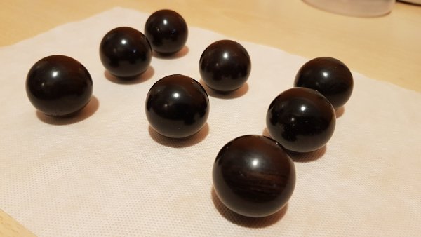

I Hello Fuscobal.
have shared this before.
Most of my used Twaeks are inspired by established Products.
(I drive a Pair of Duntech Prncess)
And the Floor in my Listening Room is made of Laminate.
(hope is the right Word)
I read about the Shun Moog Products and think about the used Wood
and the (maybe) Sound Effects of it.
I buy Grenadilla Wood. This is realy close to Ebony Wood.
but in my Country not protected like Ebony.
Which is also used for Instruments.
I ask a Carpenter to mke 8 2 Inch Balls of it.
OK? OK! (it will be good to have a helping Hand)
I Start with a 10mm Cork Plate.
Next a 20mm Slate Plate(same geom. as the Speaker Base)
Place the Speakers to the usefull Position.
Plece the Wood Balls to the Spikes Screw Holes of the Speaker
between Speaker and Slate Plate.Cost: round 150.- Euros and a bit Time for installing.
Benefit?
In my Case: the Speaker stands more separated from the Sound.
Sounds a bit airier. Looks great. Made by myself.(thats the best Benefit);)
