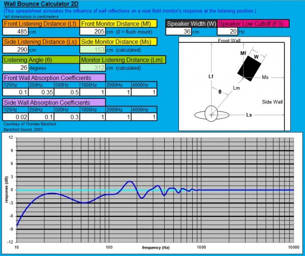

Played with this calculator today after moving the bass traps and absorbers a bit with no improvement. Distance from wall was 205cm and it seems there was a null there. Moved the speakers 20cm closer to me @ 225cm from the wall behind them and sound became much more linear with bass and midbass catching up and showing some energy. 1st pic shows a dip at 50-60Hz. On the second pic, the dip was smoothed. Problem was, theory was telling me this a long time ago but left the speakers closer to the wall because the right one is now right in the middle of the entrance in the room :)

Glad to hear you have smoother bass by adjusting your speakers. similar to my other post...It always seems that where you don't want something to go is exactly where it has to go to sound best.
Modeling and theory is great and can steer you in the right direction. But once you start measuring you can see exactly where you want to go and the impact of everything with ease. Of course, your ears are the final judge but in the bass region I have found that a flatter frequency response always sounds better to me.
Well, at 300cm the graph is perfectly smooth but I'd also have to take out my furniture :)))
