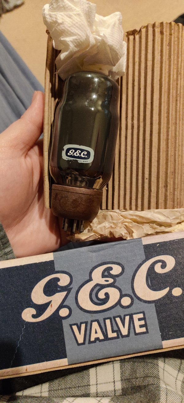

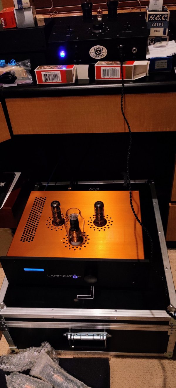

Hi all, about a year ago I purchased a Golden Atlantic TRP to celebrate having an offer accepted on a house and finally being able to set up a 2-channel. Well, unfortunately the house fell through and with the market just being horrific for buyers the DAC. I do not really have space for it in the current spot, but i decided to clear some room so I can actually hear this thing...
Welp, wow! To be honest, i always thought what I heard in my head couldn't be achieved without sacrifices somewhere, but this comes real darn close. The character change from tube swaps are significant!
While I think the stock tubes are a detriment, at least to my ears. The Gold Lion KT77s really got this in line. Added space, texture, and linearity. It was a bit more analytical, but not in a fatiguing way as it kept all the fun that Lampis bring to the table.
Next was some NOS grey glass GEC KT66s. As advertised, i think I like this better. Even bigger feel, ethereal, maybe a touch too warm but nothing I would complain about. A honey drizzled sound for sure.
I also recently purchased the F2a tubes and converter sockets, (thank you @Monsterzero !) but have not had a chance to test those out. And unfortunately I only tested on the stock recti. I would love to find an anniversary KR but i know that the best300b site has been MIA for a while.
I also really liked the built in volume control. It let me bypass the extremely bad volume pot on my Eddie Current amp (it's achilles heel tbh) and it bumped things up another notch.
I am happy/sad to see the engine 11 and trp3 upgrades. Happy as I love new lampi innovation, sad as I now want them too but it would be a waste as my dac just sits burning through warranty time.

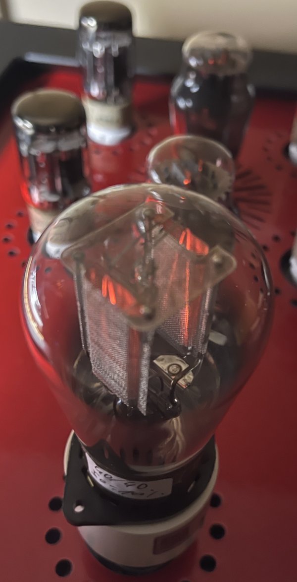

The PV200/600 is a fantastic sounding tube in my TRP. I recently put together an adapter for it, and I thought to post this for the benefit of anyone else thinking about a diy adapter for a 4 volt rectifier. The parts cost was about $65 — the bulk of that was the price of the Yamamoto teflon socket that I used. The Yamamoto is a work of art, and it seems to me that the socket is the most important part of an adapter.
To accommodate a 4 volt rectifier, we seek a voltage drop of one half volt in each of the two leads connecting to the tube’s filaments. This can be accomplished by adding one resistor in series to each of these two wires. One calculates via Ohm’s Law using the filament current, If, given in a tube data chart. For the PV200/600, If = 3.4 amps; so the necessary resistance (.5/If) is approximately 0.15 ohms. I used 5W Mills wirewound resistors.
The single best tip that I can give to anyone who wants to try this themselves is to make the leads extra long. This will facilitate the construction. Once the leads are soldered to the socket, and the socket is glued to the base, you can trim the leads and solder the pins.
I haven't used the adapter long enough to make any comments about sound quality, but it does work very well and it looks nice enough.
