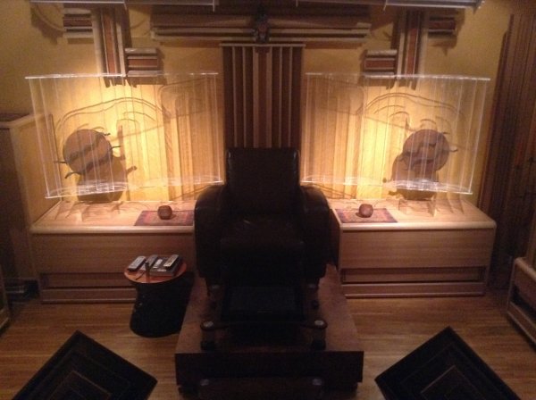

Hello Elberoth! Ok i Will post it on the Totaldac thread. These Verity Audio speakers play with the bass backwords, and I didnt get the bass right when I had them like that out in the room due to room measurments. The 50 Hz tone disapeared when the speakers where out in the room. When I "splitted" them apart and turned the bass around I got more punch and when I tried to push it closer to corners (one step at a time) the 50 hz tone came back at right power. Then i had to tune My helmholtz (where the bass was too much) to get it right. I also get rid of vibration from bass due to "splitting" them apart. I dont use any room correction, only SMT products. / Krelle

You can really put the wing diffusors so close to the speakers as 30cm? I have an email to Matts to get a couple transparent wings for behind/between my Alexias, but don't have a lot of room to the sides. But it they are OK close maybe I will get two more for side reflection points?

Hello Bobvin! Its no problem if you have 30 cm to sidewall, but not closer than that. I have 35 cm to speakers and 30 cm from My head to backwall, it works perfect. I think the first reflection on sidewall is very important.
wingregards Krelle

I believe 30cm is recommended minimum. It is actually much closer than what any other diffusor offers.

I have the S-wing on the first reflection point of my speakers and as a direct result I have been able to move my speakers more apart and still get the same density of timbre + larger soundstage.
If you are adding two V-wings behind the speakers (at the first front wall reflection point between the speaker and the listener), then you make another serious leap in performance. I am saying this although I already had Schroeder diffusors on my front wall but these wings are much more effective.

Thank you dcc :). Are you going for the transparent wings or something else? I have used SMT products for several years now. As you can see I cant get enough of these products, its really crowdy now;). Its really nice to hear every step of the way. It would be nice to hear from you what you think when you get them in place, hopefully soon.

My listening room is a small barn with a high vaulted ceiling. The acoustic measurements without any treatment are quite good with the exception of a small bump in the bass frequencies. However the RT is too long.
As my listening room happens to be my living room, I wanted someting stealthy hence the need for diffusers in acrylic. I have been waiting for S Wings in acrylic but with a height of 160 centimeters. I have been informed by Flyer that these wings will become available in May.
I will have S Wings in all four corners as well as at the first reflexion points. I will add two wings behind my listening position. Those will be fitted with casters so I can stowe them away when I am not listening to music. I will also test putting two V Wings behind the speakers.

I use the flower-wings on the first reflection on the floor. They work very well there, perfect size 60x60 cm doesnt take so much space on floor.I get more lifelike voices, better focus too. Calmer presentation and more body to the music too.I never tried them anywhere else in the room. Sometimes i write a little "Swenglish" but I hope you all understund What I mean...
