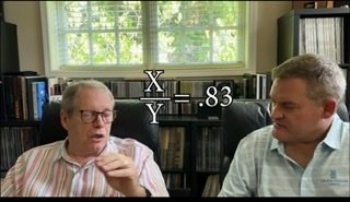

Of interest, Jim's "magic" starting ratio of 0.83 (for ear to tweeter/tweeter to tweeter distance) is the exact inverse of Wilson't recommended starting ratio of 1.2 (tweeter to tweeter/ear to speaker). I guess great minds think alike.

I believe he's saying the opposite - tweeter to tweeter / ear to tweeter, should equal 0.83? He mentions 1:1 with an equilateral triangle puts the speakers too far apart.

Hmmm…. I don’t think Jim Smith thinks 83% is the golden rule…
Scroll down to Degrees of Separation to see what he really thinks.
Tweeter to Tweeter * 1.2 = Listening Distance Example: 100 inch tweeter to tweeter = 120 inch listening distance (DAW range)
.83 * Listening Distance = Tweeter to Tweeter. Example: 120 inch listening distance = 99.6 inch tweeter to tweeter (Jim Smith)
These are good starting points, assuming room and individual speaker characteristics will support them.

Sorry, perhaps I need some more coffee, but, in the video Jim says X is the distance between the tweeters, and Y is the distance ear to tweeter.
However, in another post here on WBF, Jim wrote:
Jim Smith:
I always listen and adjust the set-up based on what I hear, but more often than not, when I'm done, it'll be about 83%.
X is the distance from ear to tweeter. Y is tweeter-center to tweeter-center. FWIW - when Wilson's X is 1.2 and their Y is 1, it happens to equal 83.33%.
When I visited Lee, the sound was congested somewhat (for my taste), as the speakers were a bit too close together. As a point of reference, I measured them after listening briefly, and they were at 79% when I initially tested them, before readjusting them by ear.
It's all a matter of taste - for me, wider separation than - say, 84% - definitely yields more accurate imaging, but at the cost of a reduced ME factor - Musical Engagement.

It winds up being the same ratio. It’s better imho to use X as the tweeter to tweeter distance as it makes very clear it’s not an equilateral triangle at all. And it feels more logical to start at the speakers then move to the ear distance.

As I understand it, the 83% is simply a ratio, not a fixed distance. Jim noticed this only after comparing the ratios of various set ups he completed. In other words, it is not the target, but a coincidence after the fact based on listening results of many, many systems that sounded right to him.
I would view it as a rough starting point based on Jim's observations and his extensive set up experience. Because it is a ratio, the distance between speakers will vary depending on room dimensions and seating distance from the speakers. The further away one sits, the further apart the speakers are from each other, based on this ratio.
Thanks Peter, agreed, 83% is a ratio, not a fixed distance. Also, I would call Jim's 83% a good starting point, along with the rule of thirds. You get a solid, dense, center image with a strong specificity of off - axis instruments, singers, etc. You may also get a bit more "meat on the bones". The tradeoff is that you end up with a bit narrower sound stage, and if you don't need / want extra "meat on the bones", you may also lose some clarity IME.
