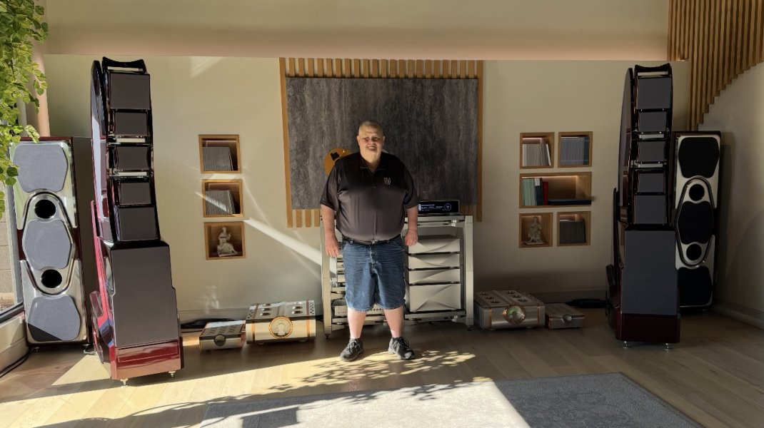

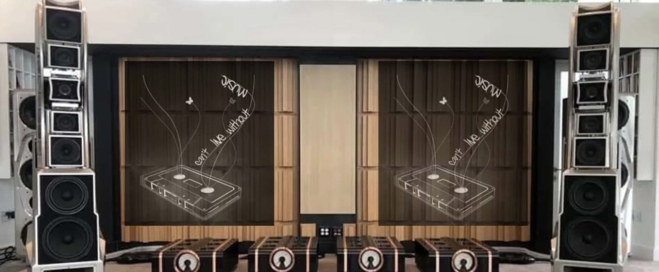

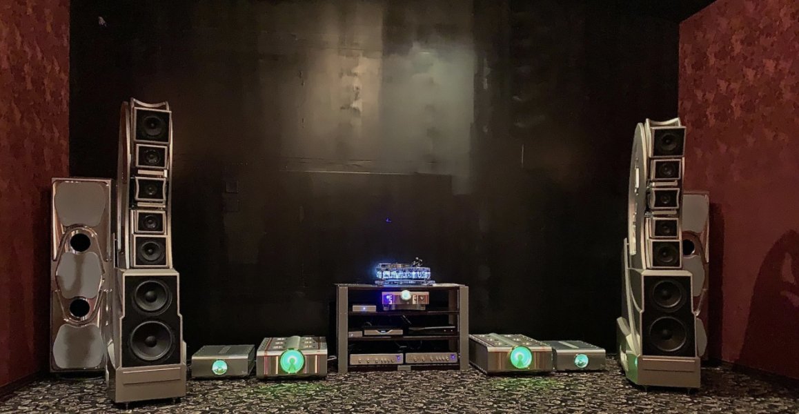

This is a question for our Wilson Audio experts. I very often see Wilson subwoofers placed in the front corners of the listening room. Attached please see examples of Master Subsonics in the front corners of the listening room. You will notice that they are behind the main speakers.
