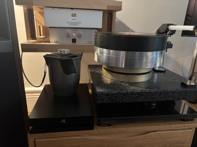

whilst a system might always be evolving, i feel right now with my la platine, i have well and truly achieved what i hoped for post the garrard 401. i have a level of fidelity i never had on the 401 (detail, resolution) as well as a lower noise floor, better micro-dynamics and just a less thick sound. my garrard 401 was setup as a shindo type setup albeit with a safir tonearm. the safir is capable of so much more so it wasn't best fit perhaps. i still get tonnes of bass and great dynamics so i am very happy with the change really and don't see myself going back.
something i have brought with me from the garrard is that i have switched verdier motor for an AC motor driven by the long dog audio speed controller. my verdier motor was quite old a bit noisy. the new ac motor has great speed stability, is quiet as the grave, and brings out a full suite of sounds from records such as i haven't heard before.

sure. the motor is a " 9904 111 31813 from Allied Motion Premotec"
rpm is 250. i use it as 110 volt with 50hz. can be operated on 240 v though too. i am in australia (where we have 240v) but the long dog audio is switchable.
i installed a 12 mm outside diameter pulley on it. i then installed a 40 mm outside diameter (bought from Harfington) on that small pulley (inner diameter of larger pulley is 12 mm and it fits great).
i use the Long Dog Audio speed controller with this. i had an old Sogon Power Cable from audio note and my audio dealer was kind enough to terminate this with powercon for use with LDA SC.
I attached the motor via bolts to a small board i had from a coffee scale i bought
I then taped this board to a crucible i bought from ebay. the crucible is graphite so drillable. didnt need to drill it in end. i got the crucible as it was the right height (180 mm or so). i filled the crucible with spare change to weigh it down. i use a linen thread. it has great grunt and speed is 100% locked in.
so i could now put this in a better housing but honestly my system sounds amazing so not a huge priority right now. the new motor versus my old verdier motor is like comparing an asthmatic on deaths door with Ben Johnson at the 88 olympics. no contest.

oh yes. quite essential. as per Galibier paradigm, one is trying to get rid of any elasticity in the mix. once i did that, leaving only the belt as a point of elasticity (and with linen even that is very limited), the system came to life.
