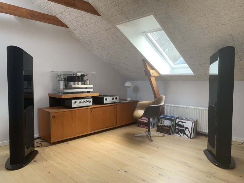

The picture I attach here shows what I see of the sides of the speakers from the listening position. Somewhat more toe-out than what GoldenEar recommends, but I find the treble balance natural this way.
Very similar toe in to the set up here:

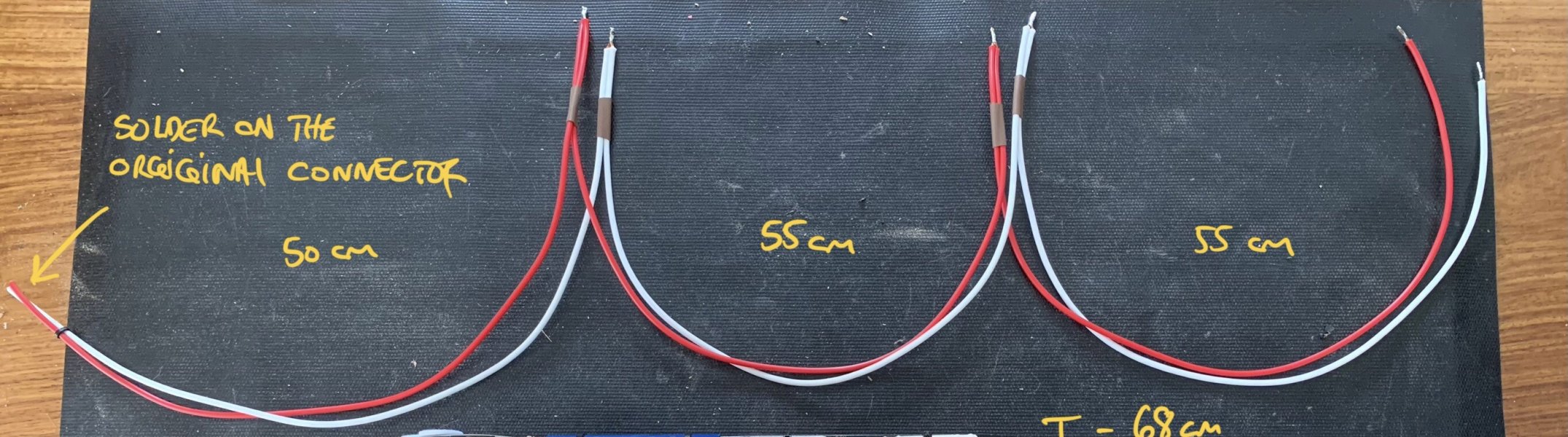

I don’t think I have shown this earlier, but here is my wiring for the 3 subwoofer drivers. It’s stripped Furutech, same as for the other drivers.

The wiring + connectors for the bass is the same terrible quality, as for the MTM section, and I doubt any of us would use that low quality wire and connectors as speaker cables/connectors between our amp and the speakers. At least I would not = I don’t want to use it between amp and speaker drivers inside the speaker either.
