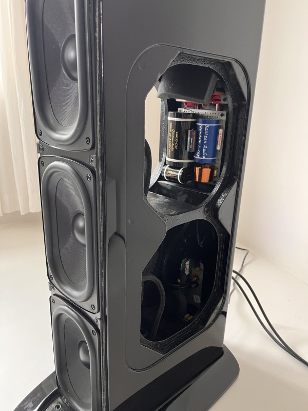

I dissasembled one loudspeaker and got rid of the stock filter and cabling. Up until yesterday I was considering an external filter and leave the stock filter in place..... but after seeing the actual difference, I know I will probably never ever use the stock filter again.
So, it will be a straight forward swap for me. Mostly because the new filters are a pretty easy fit. So BIG kudos to @MortenB and Tony as the new filters slide in nicely. No need to remove braces. Just make sure the filter sits in the middle of the width of the cabinet, and the radiators have 5mm space around the caps. See pics underneath.

Yes, we have been back and forth on the layout quite a few times to get the biggest parts towards the middle of the crossover boars. This to give enough clearance to the baskets of the passive radiators as you mention. It’s a tight fit, but working through the holes of the passive radiators, it’s actually quite easy.
Agreed, the existing components and wiring are of such a poor quality, that they are of no real use…
Your filters from Tony are smaller than mine (some of my caps are different/bigger), so great, that this filter fits without removing the small brace. For those who have removed the small bracing, you can just glue in a ‘’rundstok’’ as suggested earlier. It will do the same work.
It’s a bit hard to grasp what is up - down in the cabinet from your pics. I get the impression, that you have the board with the big black Jantzen caps up in the cabinet, and the other board with the foil coils down towards the binding posts? Or do I get the wrong impression from the pics? (I would install the board with the big black Jantzen down towards the binding posts).
Yes, try and ‘’rotate’’ the boards. With the big black Janzen down in the cabinet you will get the shortest wiring:
1 cable from the binding posts to the input of the filter.
3 cables from the board with the coil foils up to the drivers.
That’s the intention with the layout.
It will shorten the wires to the driver considerably. So yes, this is the way.
My advice would be before drilling the holes for the board, to have one radiator in place. You can slide the board towards the radiator, and just slightly pull it back (1-2mm) after it touches. Then try the opposite radiator, see if it clears the boards as well.
After a quick check, I managed to get the "Big Black Jantzen Board" between the radiators this way. It's tight, but it fits! See pic:
Yes, that’s exactly the right process to be sure to install the boards in a way, where the passive radiators will still fit. Those baskets on the passive radiators are taking up quite a bit of space.
Yes, it will take some work with care. But when done correctly, all will fit nicely. With the radiators in place, you can wiggle the board about 3mm. This is a handsome design @MortenB :)
I told you those damn basket for the passive radiators are in the way ;) With these much larger filters, the only way to install them inside the cabinet is on the back panel.
I stuck some small self adhesive felt pads on the caps, next to the baskets, just to make sure nothing would rattle. But if you have 3mm clerance, there should be no problem what so ever.
I’m guessing the bracing I have marked with red is the one seen over the Silver Z capacitor in your picture? Meaning you have installed the crossovers higher up in the cabinet, as I have marked with green here on my picture?
All is fine with that of course, especially as you use thinner and more flexible cable from the filter up to the drivers.
For those of you who has ordered filters from Tony with the Furutech cabling already done and soldered to the crossovers: If you prefer the location Markuzz use, the Furutech cable between filter and binding posts is most likely too short, so you will need to replace that. Also please be careful not to bend the thick Furutech cables to hard/tight when routing them up to the drivers.
Or use the same location of the crossovers as I did, where you need to remove the small bracing discussed earlier. The cabling is made for this location of the crossovers. As you can see here, the cables are routed with ‘’soft bends’’ between filter and the midwoofer cabinets.
Both locations work perfectly fine..!

I completed the filter swap. Yesterday I did some preparations, and today I soldered the wires to the filters and drivers. I followed pretty much all of @MortenB steps. Thus, hot glue for an air tight seal between the internal cabinets. Also tight wraps to secure a strong cable connection on the drivers.
I reused the screws of the stock filters to fasten the new filters (plus 2 extra). Just a small pre-drill through the filter stand mounts, and carefully screw down the filter. Super tight, and done in minutes.
For now I left the cables for the active woofers stock, and I used about 2.75m per loudspeaker to wire the passive section. I spend about 8 hours in total to do the full swap, including testing.

You think the small original screws will be be enough to secure the boards? (As long as the speakers are not shipped, I guess it’s OK).
Yes, the screws hold the boards fine. I only pre-drilled for the screws to grab into the wood, as the screws only go 6-7mm in. But 8 pieces secure the boards nicely.

Interesting, I did not find the small original screws secure enough, but again: Different people, different perspectives.
