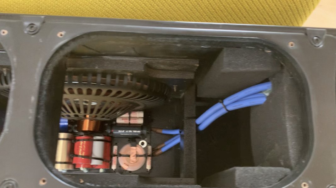

I took some detail pics during installation of the new cross overs and wiring to help others, in case anyone is crazy enough to do this I’ll be happy to share them here…
Just to follow up on my previous post and some detail pictures and explanations. I’ll make few posts with different details on the upgrade. Let me know if more is needed…
Installing the cross over inside the speaker:

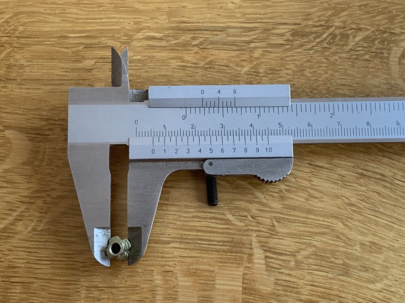

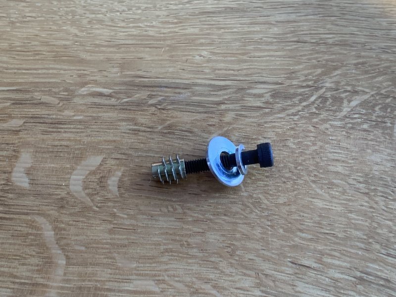

The new crossovers are much heavier, and larger obviously. I used these threaded inserts + M4 bolts for the installation. The hold the boars very securely in place, and don’t sit very deep meaning no risk of damaging the beautiful paint finish on the back (imagine drilling long screws out the back). I used rubber stand-offs between the cabinet back and the underside of the crossover board.
With this location of the crossover there is just enough space between the baskets for the passive radiators, and as seen the Furutech cables running to the midwoofers and tweeters run from one end of the board.

A bit of drilling is needed:
The Furutech speaker cables are thicker than the original wiring, so a few new holes needs to be drilled in the inside cabinet wall between the woofer chamber and the midwoofer chambers. There is one hole already for the original wiring, two more needs to be drilled. As shown here it VERY important to get an airtight seal around the cables to isolate the midwoofers from the pressure in the woofer box. I used plenty of glue on each side.
When the speaker is put back together and all drivers are installed, we can check for air leaks by pushing on the woofers. When doing that the midwoofers should not move. If they do, there is an air leak and it must be fixed before playing the speakers.
These pics indicates how to run the new cables, notice also how the cables are cable tied to the bracing. Not difficult.
