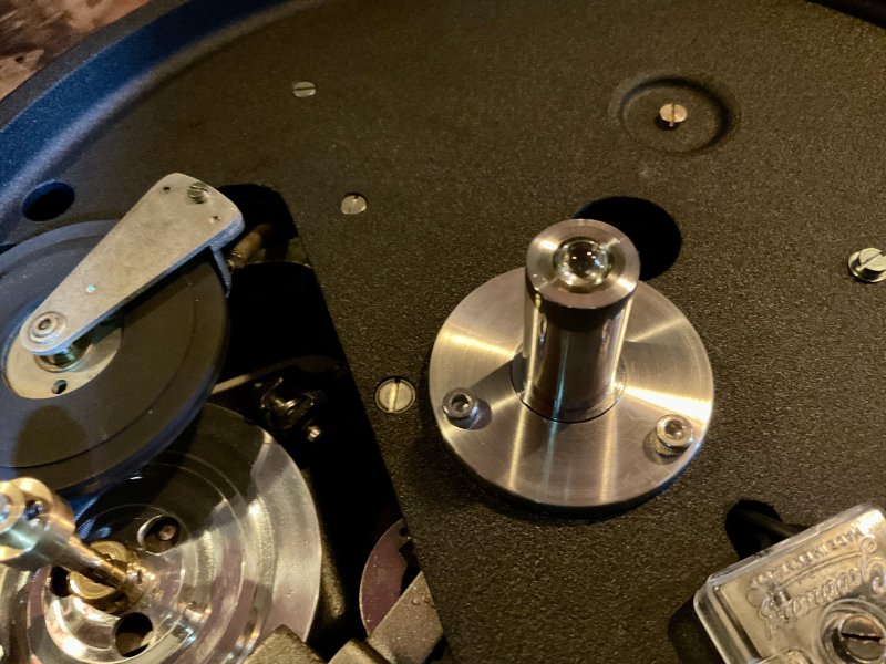

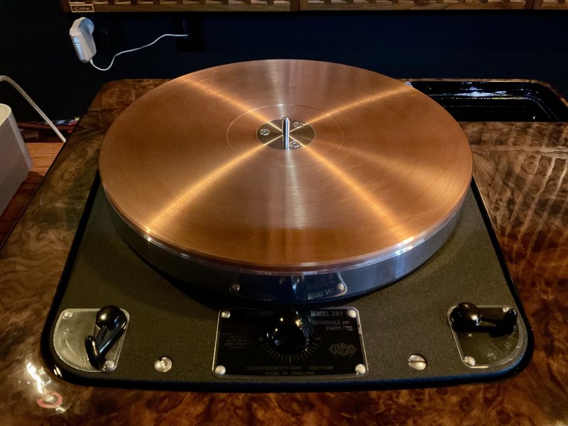

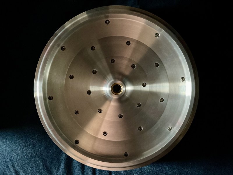

Totally, agree with your assessment. I recently replaced the stock platter on my Garrard 301 with Artisan Fidelity’s oil-based sapphire bearing and their inverted large-bore bearing, paired with the modular copper-hybrid, internally damped platter. The improvements were very meaningful—enhanced inner resolution, a lower noise floor, and noticeably better left/right channel separation. The platter itself is a work of art, both in scale and finish.
