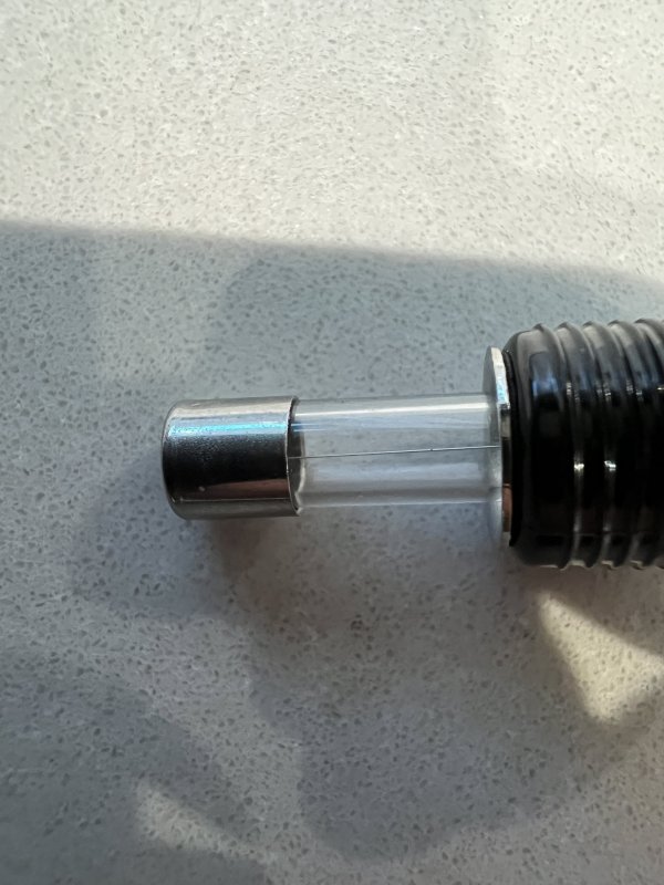

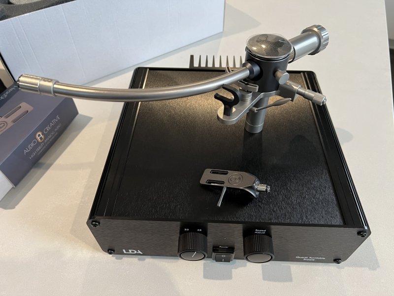

Various toys are arriving, a power supply from Nick Gorham and a rather nice new Goovemaster headshell.
The output fuse on the power supply is 0.315A, the fuse freaks would no doubt lose sleep over their power going down such a thin wire, but that's life.
