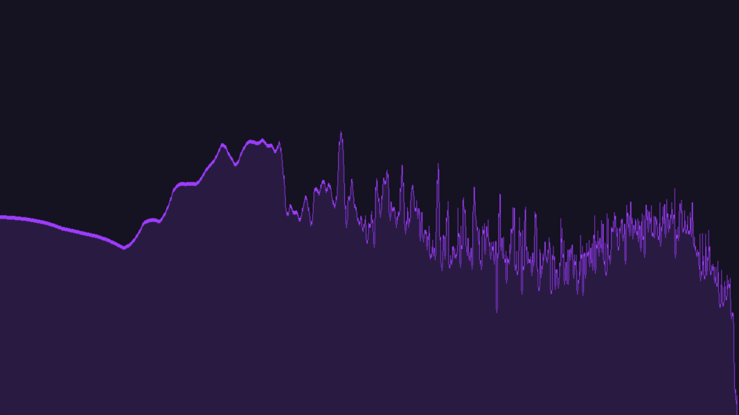

the meat and bones of sibilance live in the region of 3kHz to 8kHz. That range of the frequency response is what, when in excess leads to ss, tt and tchh sounds being edgy and painful.
looking at the spectrum analyser of my music player, during any passage with the phonetic SSS, there's a jump in the spectrum from what is normal for music spectrum(which is either flat and sloped downwards)
The image above is the song paused right on one of those SSS and you can see the spectrum jump in the lower treble to mid treble and uyes that is the region for sibilance. Couple that with maybe a system that is presenting as bright in your room and that will be exacerbated further.

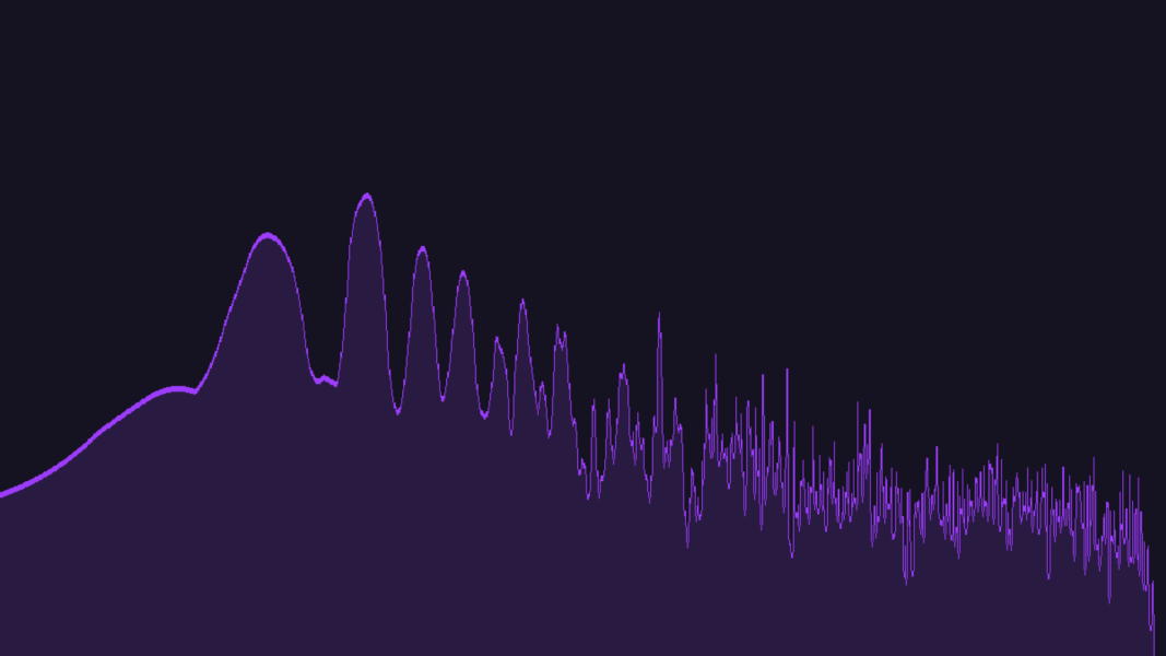

Below's a different song with better control on the sss with tools like de-essers

the above is Fast Car by Tracy Chapman. As you can see it is smooth in the rate of fall off from bass to treble. Not all songs are mixed with this balance but generally songs follow a semblance of tilt from bass to treble. Treble is present but not aggravating on Fast Car.
So yes, the Holly Cole Song is sibilant in presentation and if you have a system with tonal balance listening on bright. it won't be an enjoyable listen.
I don't have a sibilant system, but do not have a dark one too. Just right, neutral. But that means I notice songs that are sibilant much easier than if my speaker/room RTA dropped off a cliff after 1kHz. On the other hand, if you have an overly present in the treble setup, even songs like Fast Car will sound sibilant
