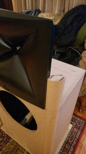

Nice! I have been getting my new set-up built. Got the bottom cabinets done hoping to get a listen soon. Have to build the tops next!
Rob :)20200416_202117.jpg20200419_113514.jpg
Rob :)View attachment 64225View attachment 64226
Cool, is that the JBL M2 waveguide? Are you using the JBL driver that goes with it (can't remember the model number) that is a dual diaphragm design? Will you be using digital xover with DSP?
He is using TAD
