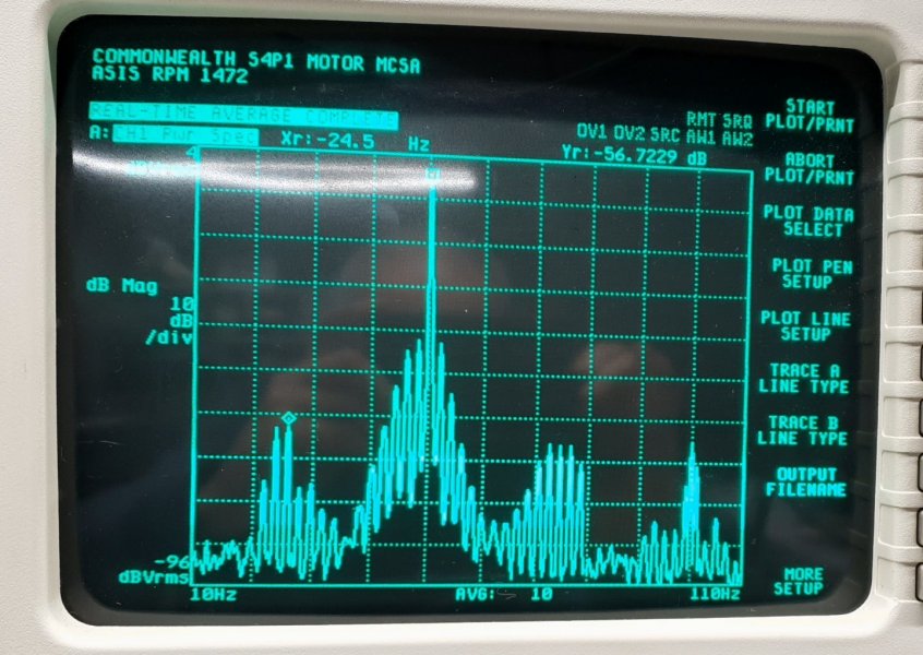

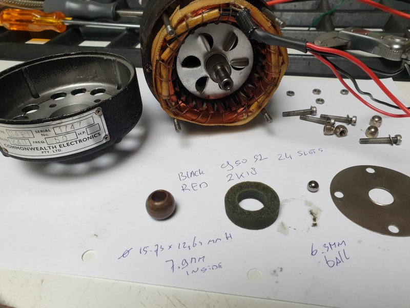

The revision was done for a customer who made his own console for it can't publish that .
But let me know when you are going to start with the revision the pictures showing the motor , main bearing and two pictures from the motor current spectrum the first is asis the motor does not lock on speed its a reluctance motor ,
Second after overhaul and perfect stable speed , got more pictures also from the power supply and the influence on the vibration.

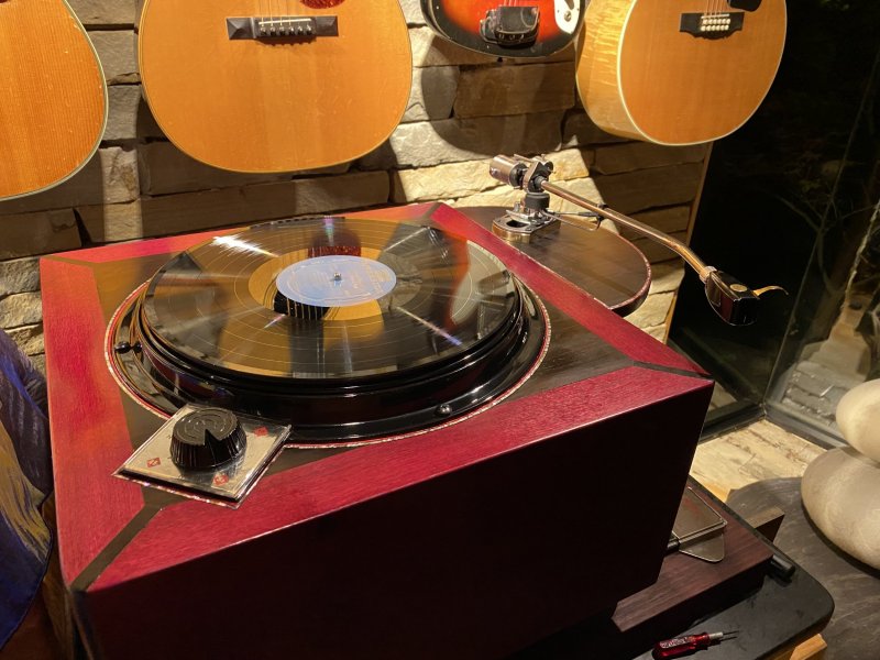

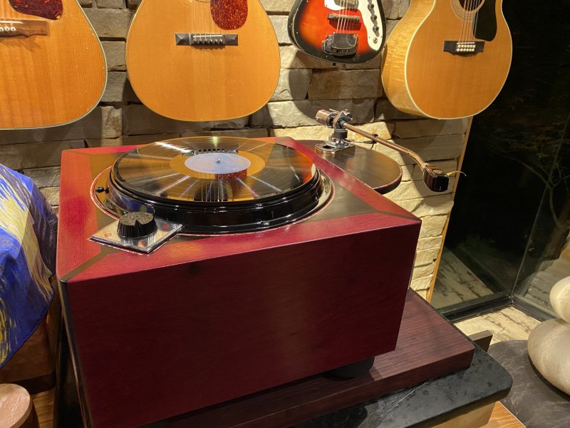

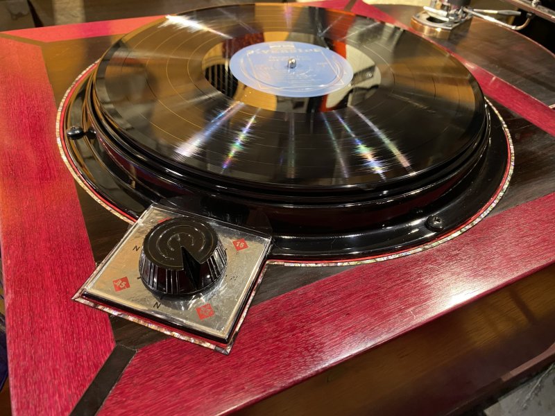

A long time has passed since I started on this project... sigh. I thought I'd post some quick pics of the final outcome - actually, not final because I still have some more work that I want/need to do to get this sounding it's best, I think...

How is it sounding now vs your others?

Comparing the Commonwealth to my other tables…. It‘s insanely dynamic. It kinda out Garrards the Garrard. It really has a sense of momentum that I’ve not experienced from a turntable before. I feel like a faucet has been opened all the way and music is pouring out of my speakers; it’s very exhilarating to listen to.
It does still sound a bit coarse compared to my other tables though - wow and flutter isn’t measuring quite as low, and I’m thinking this is at least part of what I’m hearing.
I still have some tuning and some other new parts to have made. All to say, I think it has incredible potential. I don’t think it’s all the way where it can be yet.
