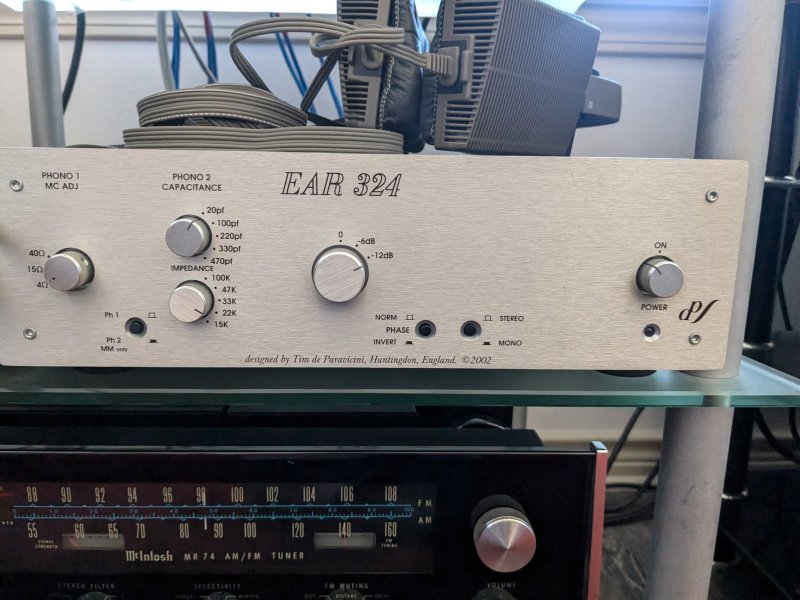

I currently use a EAR 324 solid state phono stage. I bought this in 2008 or 2009, I can't remember. Very versatile and it's solid state which I prefer over tube/hybrid tube design.
Looking for possibly the next step for me might be a FM Acoustics FM 223 Phono Master. Lots of versatility but at a higher point of resolution along with a much higher price tag too...
Typically FM Acoustics electronics sound best with other FM Acoustics electronics, cables, and speakers, at least to me.
