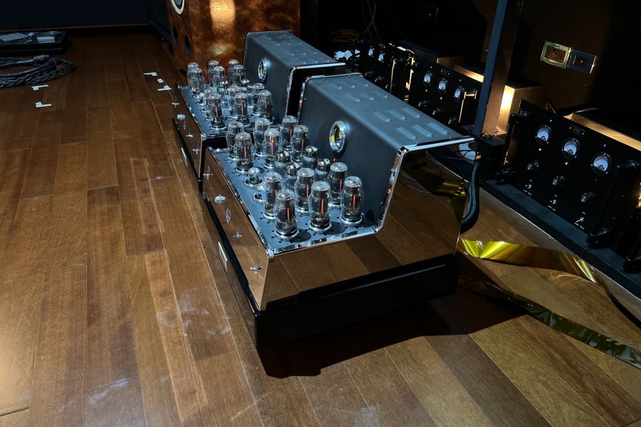

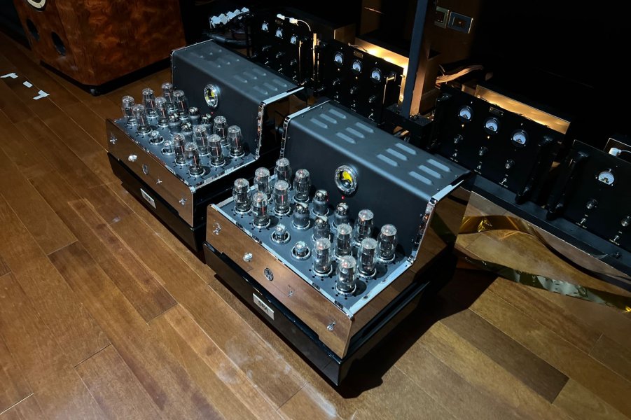

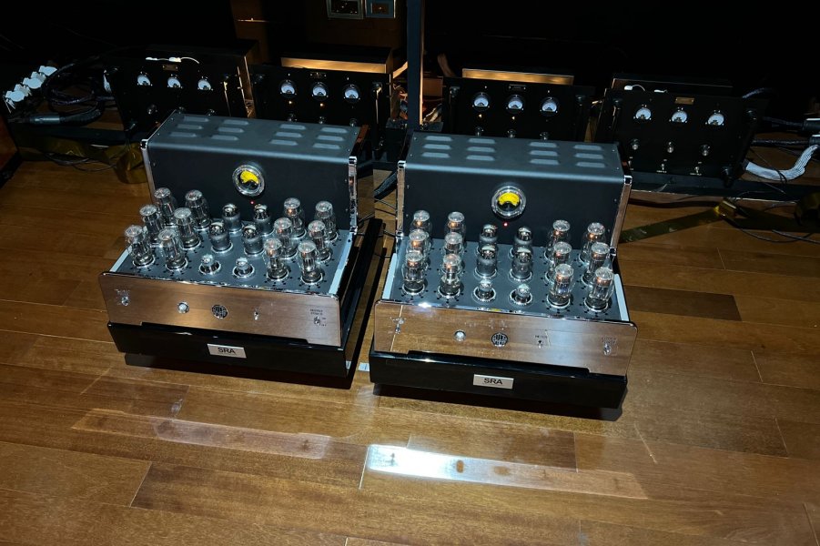

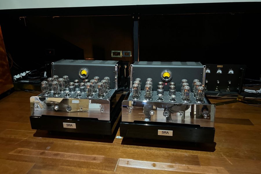

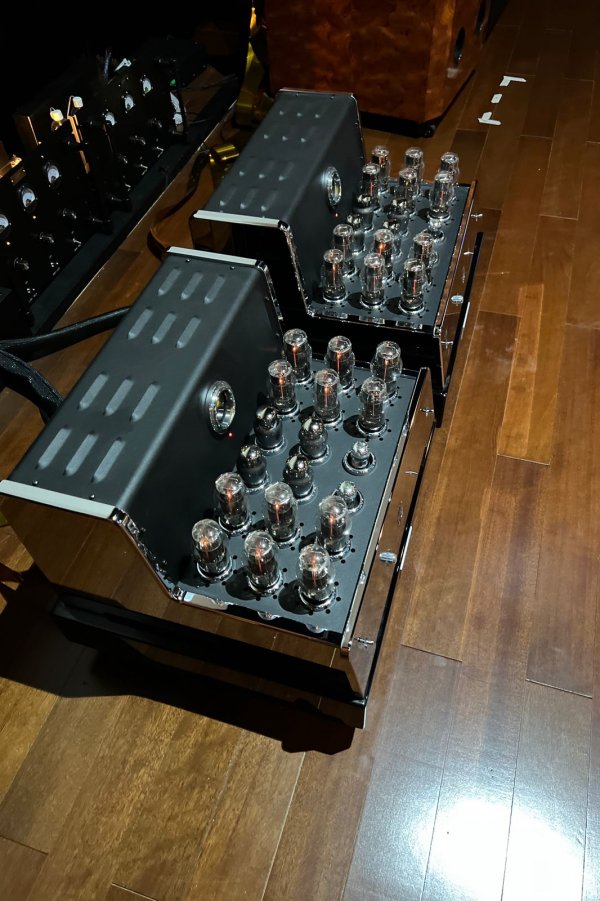

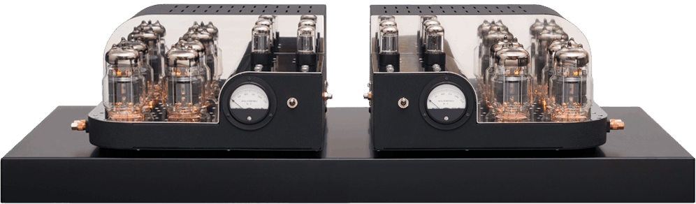

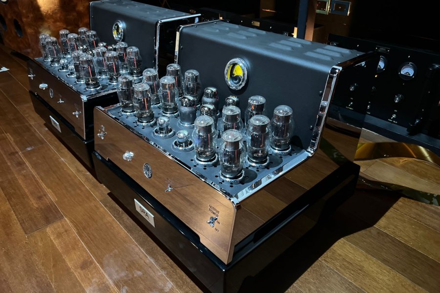

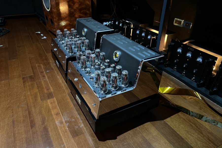

This has been Ralphs's Masterpiece Amplifier, a no-compromise design, Which retails now at 65K but is built to order only. I thought il post in this group as it's a rare build and commission upon request.
Iv owned all of Atma-Sphere Amplifiers and Pre-Amps. and have evaluated all his amps carefully; this is by far the best sounding Amplifier Ralph has ever built.
I hope Ralph can chime in and explain the complexity or the spec of how this differs to the rest of his other amplifiers.

With 6 power tubes per side I’m guessing ~90 into 8 Ohms?
They are 120 watts into 8 ohms. Full power from 2Hz to 100KHz within 1/2dB. THD is about 0.5% when the amp is set up properly (this can be affected by tube choice since it is a zero feedback design). Its nice and quiet so no worries on speakers with 105dB efficiency. It runs regulated power supplies for the driver high voltage and filament circuits.

Beyond the obvious metalwork, this amp employs a fair amount of regulation in the driver section- regulated filament supplies and high voltage. The driver and output sections are built on sub-chassis within the main chassis. The power transformers are all overbuilt to an extreme for the application. We used a high performance Panasonic capacitor in the output section that uses multiple connections to minimize inductances in the part.

Ralph could tou explain what are the Hexfred? and how much quieter this is against the other amps. i beleive you mention it was over 9db quieter ?? or more
The amp does use HEXFRED rectifiers throughout. That's not unique in our amps- our S-30 is built that way too. Most of our amps have HEXFREDs in the driver power supply and regular silicon in the output section. Which one we use depends on the resonance formed between the power transformer and the junctions of the rectifiers and in the S-30 that means we have to use the HEXFREDs there. We did that in the Nirvana as a bit of overkill. The lower noise IMO has mostly to do with the regulated supplies.

The reason it is so much quieter is all the regulated power supplies. At the time that amp was conceived Tenor and Einstein both made amps with a similar price tag and neither sported any particular circuit advantages. They got away with it on bling alone. We figured we could do that only with the internals to match.
I think the Nirvana is a better amplifier and may be the best sounding we have made ( He was quoting against the MA Series and Novocron)
The Nirvana was built to see what was possible if everything in our OTL design were pushed to the limits. So everything in it is over-built, for example the power transformers are built with the least DC resistance allowable in their windings to prevent voltage sag while under load and also to run cooler. Sub chassis were used for the output and driver sections; filament and high voltage power supplies are regulated and ultra high performance filter capacitors employed in the output section. HEXFRED rectifiers are used for all the supplies and properly snubbed for ultra low noise operation.
On account of these measures the amp is silent on horn speakers and has very low intermodulation distortion, resulting in a very clean and musical first Watt. The sockets were custom built by Ebe, the last American manufacturer still making tube sockets. They will last decades. If course the amp is built with V-Cap Teflon coupling capacitors and high end resistors, custom wire made just for Atma-Sphere; every aspect of the amp was given this sort of attention. Naturally the chassis shows this off with super-polished and chromed machined panels showing it off.

A stunning-looking amplifier and a departure from Ralph's usual design esthetic. I would love to hear these amplifiers one day, but I am sure they sound terrific. Congratulations Ralph!
I have long been a fan of Atmospheres Novacron, also a departure of sorts.
I have owned Atma-Sphere amps and preamps for over 20 years. I never knew these Nirvana amps even existed. Just stunningly beautiful. Would like that kind of bling on my MP-1 preamp.
