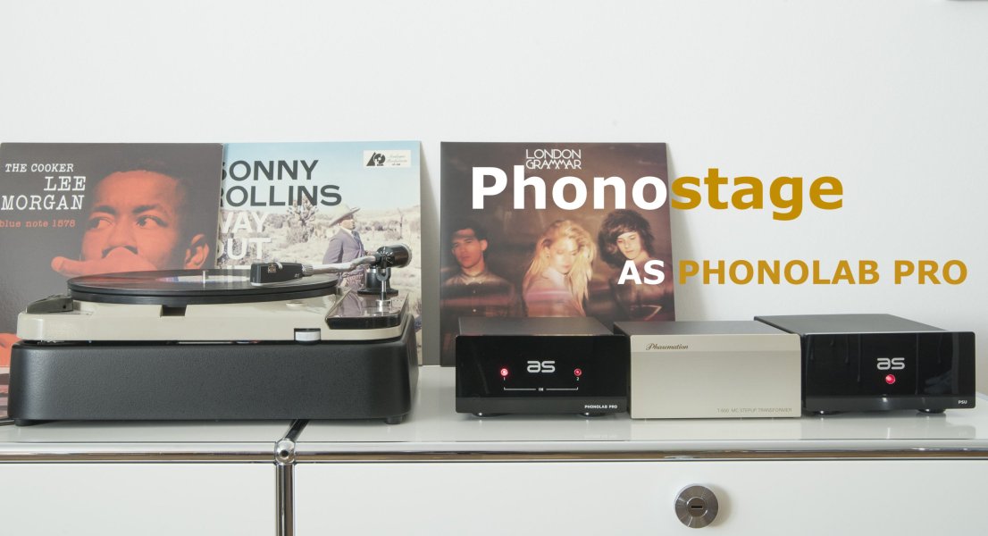

In the meantime, more and more vinyl lovers are acquiring a taste for transformers and matching phono stages. Our german AS community member combines his Phasemation transformer T-550 with the AS Phonolab PRO from Audiospecials in the 16KOhm setting at the MM input. The Ortofon SPU Classic GME comes more alive with this low Impedance he reports. I asked him, what amping do you use?
Devialet, it works great. This chrome beauty I like for its look, too. Recordplayer is the Bauer DPS-3.

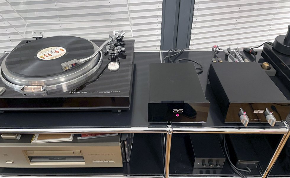

The Kenwood KD 750 is certainly still known to many as a top recordplayer of the late seventies.
I asked its owner, why just the KD750 with the AS Phonolab?
"As a pianist, I simply have a strong association with my Steinway grand piano whose deep, black, noble high gloss reflects the grandeur of my classical music. The Kenwood conveys this to me, as does the AS Phonolab phono amplifier from Audiospecials.de . Completely handmade, it shows that - Made in Germany - today again stands for a tradition that can be described as a combination of sophisticated design and outstanding technology. The AS high gloss front in deep black also reflects the spirit of classical music. On the other hand. It has two inputs for two tonearms. On the right side is my Nottingham player in the OFF.

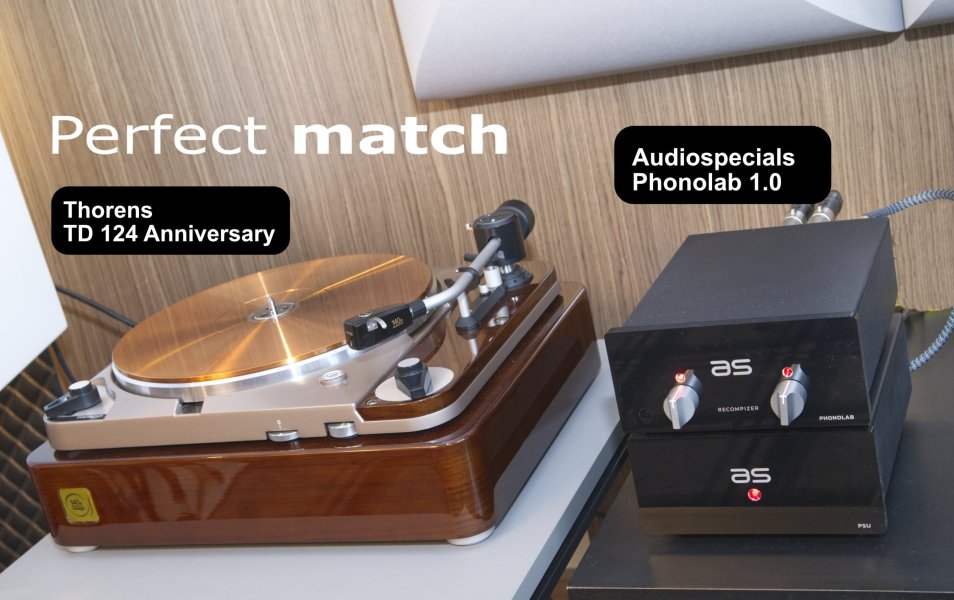

The AS community likes to share photos of their SET Up. Here is a very successful combination of Thorens TD 124DD and the Audiospecials AS Phonolab PRO below.
Phonolab_PRO_2.jpg The outstanding signal to noise and thus also dynamics never cease to amaze. This is 100% handmade, a very exclusive product Made in Germany Cologne.

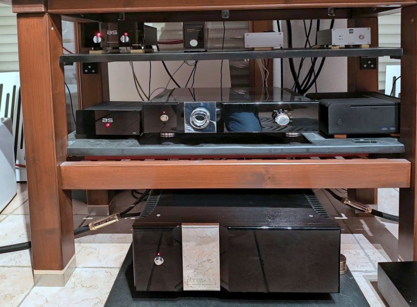

Audiospecials Phonolab and surroundings...
