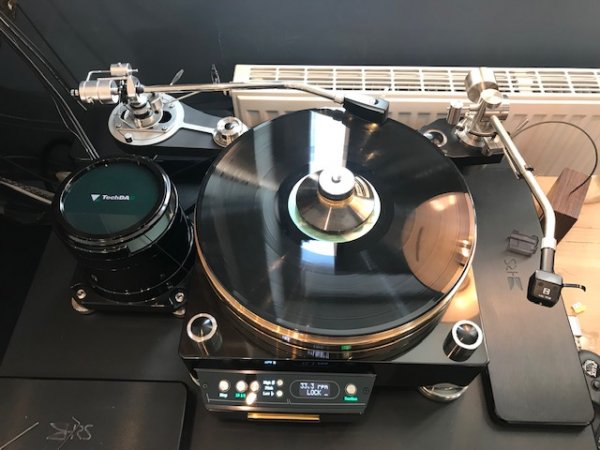

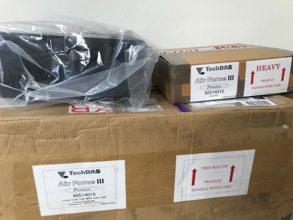

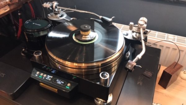

Today in the morning I was happy to see DB Schenker coming , delivering the 2 boxes of the AF3P :)
It took me some hours of relaxed fitting to get the first music out of the AF3P, it took so long, as I enjoyed every minute of assembling the perfect Japanese "machina".
I placed the AF3P on my Accurion I4large active base, which is also cover plate damped by some HRS Nimbus dampers.

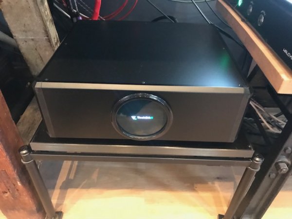

The new 2 circuit pump is placed on a separate rack to avoid any vibration to the AF3P.
The AF3P was shipped with a 12' SME tonearm base, so my SME 3012R has the fortune to take place on an original TechDAS tonearmbase. I ordered also a 12' Ikeda Base, but this one will ship later November. So I tried the original Micro Seiki GunMetal Tonarmbases. And to my pleasure, they fit perfectly.
So I was able to fit my beloved Fidelity Research FR62 S silver cable version as well. The FR 64s is with the B60 lifter , so a very heavy base.
I left both arms with their fitted Carts, an Ortofon SPU on SME 3012R and the FR 702 (latest EU Version of FR7z) on FR64s.
Without doing any fine tuning, fine adjustments the functional check already shows, that the AF3P plays on a very high level with a lot of resolution.
I will spend the weekend to add an Ikeda 407 an to do the final fitting of Carts.

Congrats Shakti! It looks very good on that base. What is that little wooden box next to it?
I hope i got mine next week, looking forward seeing all this.
Funny i have ordered it with an Ikeda 12"base and have also some older AX4 Micro-Seiki tonarmbases for using with SME 3012R and another for AS Axiom. I hoped it would fit but it seems it does, thanks.

The original Micro Seiki Bases (one fixing version) should work.
Some of my free aftermarket counterparts do not fit!
It seems, that the tolerance of the AF3P fixing is more in the plus, so general fitting is more tight.
The distance between the fixings is a little bit longer, so the 2 fixing bases for (from) Micro Seiki do not fit!
