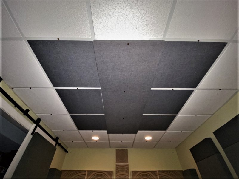

So this is my listening room.. no treatment as of yet... reverb time at the moment ranging from 2 sec (low Freq) to 1.2 sec (higher Freq) want to get this to around 0.5
Size of the room is 11 metres x 9 metres (floor surface) x 3.7 metres high ceiling (highest point)
I was thinking of DIY.. and utilizing the horizontal beams where the lights are resting up (they are located at 2.5 metres above the floor)
Basically I was thinking about making boxes with Rockwool. 4 boxes of each 2.4 metres long and 1.2 metres wide. and putting them on the beams... this would give me almost 12m2 of acoustic material..
behind the speakers I would put some diffusers..
Do you think this would be a good idea ? something else I'm missing ? I don't think I need to worry too much about first reflections in this room.. because of - in my opinion - the sloped walls, the sound waves tend to bounce upwards.
Thanks for any input

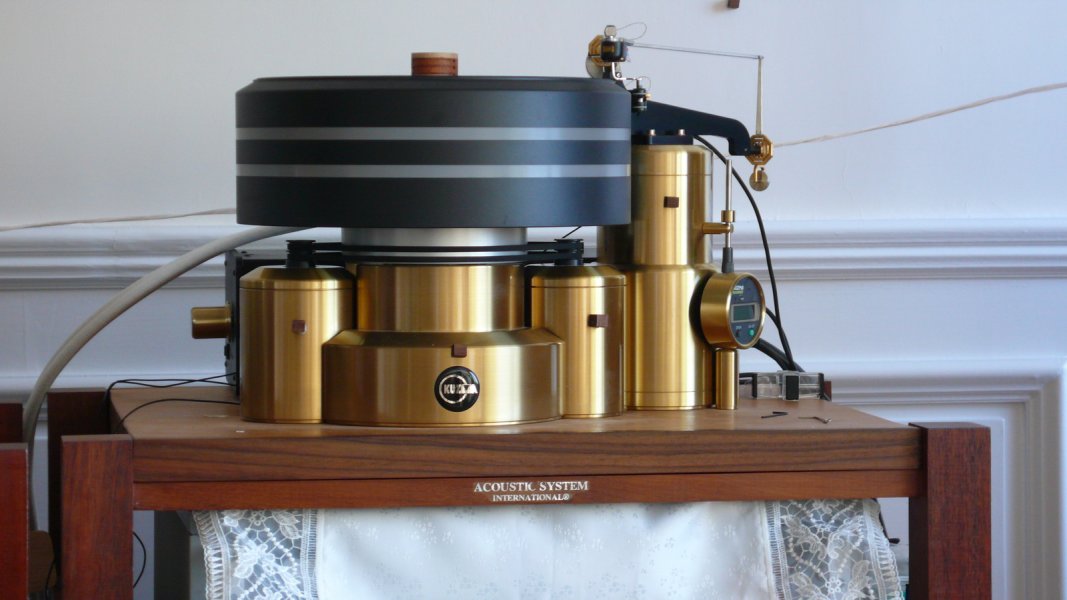

Nine months after your original post I tried ASI "Sugar Cubes" instead of additional panels to complete my ceiling acoustical treatment (see photo) and was surprised at how effective they were. I was inspired to do this after reading about their similar use by Asian audiophiles in very high end systems (e.g., Audio Exotics, Hiendy.com) - photos below. Based on my own experience and what I've read I would expect Sugar Cubes spaced 20"-24" apart along the various beams and cross members in your listening room to effectively take them out of the equation as sources of reflections. At $12.00 each from The Cable Company it wouldn't cost much to experiment.
