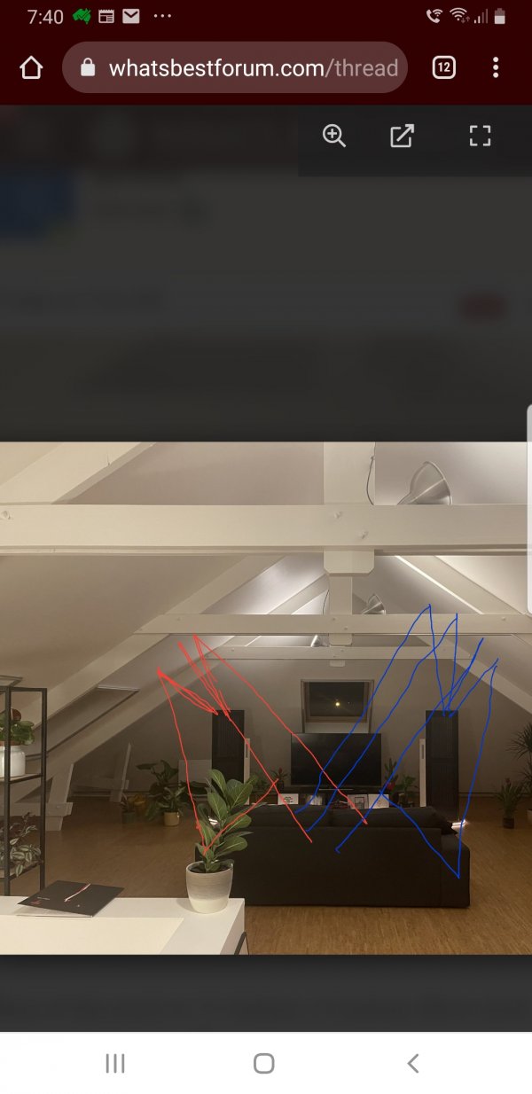

As Marc said the ceiling is the big one as that is the source of majority of your first reflections
Absorbers and diffusers will only mess up the reflected sound as they no longer correlate with the direct sound so a vertical baffle sytem that redirects reflection away from listener will work best .. your beams will already be foing a bit of that
The pitched ceiling does complicate reflections as it focuses them on listner Screenshot_20211120-074251_Chrome.jpg
Before these are positioned you should try finalise speaker and listening spot and add in enough baffles to give some flexibility
Marc has used pet panels and these have worked well as they absorb a little as well
Your front wall can be looked at in the same way .. just redirect reflections
A good program to work all this out is amray trace .. if you can get your head around it
For reverb time I would firstly focus on low bass .. look up diy stuff that goes low and put it in the corners down your sides and at bass of front wall would be good ... try 3m or so to start
My 2 bobs worth

That is remarkably similar to Marc's room .. looks very cool
The pitched ceiling does complicate reflections as it focuses them on listner View attachment 84972
My 2 bobs worth

Hey Phil,
thanks for your input... so basically you are saying I should hang baffles from the ceiling ? but vertical instead of horizontal.. but how exactly ? cause what's the difference between absorbers and baffles ? isn't a baffle just the same ?
sorry that I don't fully understand
EDIT : I saw some pics from marc's room.. I understand how the baffles should be positioned ;)
but baffles have same effect as absorbers, no ? positioned the same way as in Marc's room they do an even better job absorbing..

Hey Phil,
Germinal
Well they do asorb a bit and do work a bit harder in this baffle arrangment but the main advantage is that any sound reflected is away from the listener where it would smear between direct and indirect ... with your ceiling you will have some very early reflections ( maybe reduced a bit by narrow vertcal dispersion of speakers?... not sure .. but would still be there)
The advantage is you dont loose ceiling height .. in fact if you dont hear reflections it seems taller
I think you have to be very carefull with broad band absorbtion ( kills the room)and I would only approach that after you tidy up reverb and first reflections

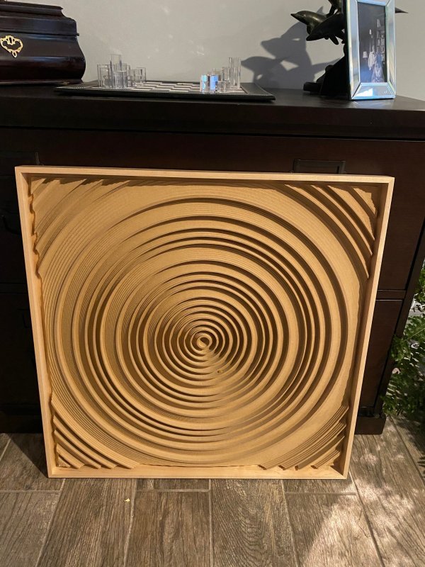

There is an alternative to the conventional room treatments that everyone is recommending that you might want to take a look at - DHDI ZR Acoustics' thin panels that reduce/eliminate reflections (all frequencies) without deadening the room the way absorbers do. I tested them extensively and deployed them in my listening room (see photo). My experiences are described in this thread:
Also see:

I was thinking of DIY.. and utilizing the horizontal beams where the lights are resting up (they are located at 2.5 metres above the floor)
Basically I was thinking about making boxes with Rockwool. 4 boxes of each 2.4 metres long and 1.2 metres wide. and putting them on the beams... this would give me almost 12m2 of acoustic material..
behind the speakers I would put some diffusers..
Do you think this would be a good idea ? something else I'm missing ? I don't think I need to worry too much about first reflections in this room.. because of - in my opinion - the sloped walls, the sound waves tend to bounce upwards.
