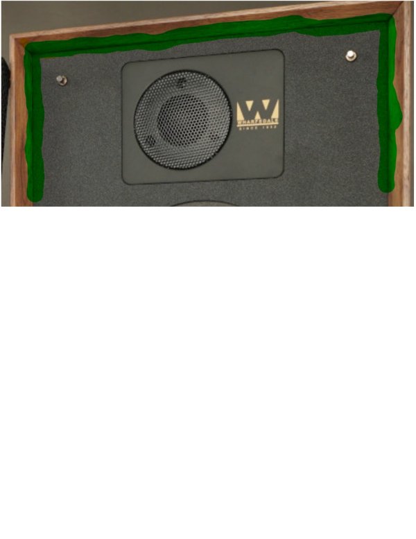

could you buy a dac with built in eq options then come up with a couple different eq curves one for the recordings you like the sound of and one with a tailored sound to take the harsh treble out of the recording you dont like . a cheaper option would be some wool felt strips double sided taped either side of the tweeter that should kill the diffraction which could be causing the problem. worked for me with my dynaudio bm15a they were bugging me for years on some recordings . I sent off for some samples from a industrial felt producer and the free samples were enough to do the job. pretty sure the wharf dale lintons have side panels that stick forward of the front of the speaker to give that 70s classic look . they would have known this would cause diffraction but chose to compromise the performance for aesthetics

I do have D90 III Discrete that comes with PEQ built-in. I will try. In terms of wool felt strip application, does it look like this?
