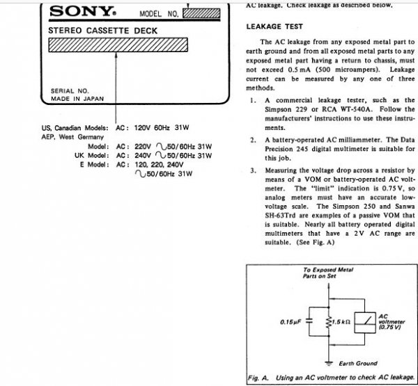

IMHO you should have your mains diagnosed and also ask the advice of Doshi. Does Doshi Audio use mains filters in their units? Can you measure your equipment individual leakage current?
Interesting that you should say that. Nick actually reached out to me after seeing that I was looking for power conditioning assistance. How's that for customer service!
Nick really likes his equi=tech unit which is why I am rethinking this after having made the decision to get a Torus. He said he would look at the specs/technology on the Torus for me.
I am not sure how to measure the current leakage. That is not something I have ever done.
My electrician is coming next week. i am going to ask him to diagnose the mains, if he can.

Sony can help us. If your equipment has ground you need a cheater plug to interrupt ground and all cables should be disconnected from the equipment being measured.
