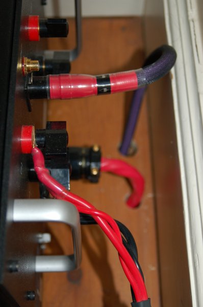

Mike, Have you considered bypassing the outlets all together and simply running the direct circuit from the Equi=tech cabinet through the outlet opening (cutout in the wall or baseboard trim) and terminating it with a Furutech IEC and plugging directly into the component? This means you are essentially making your own power cords plugged directly from the component into the panel, no extra connections.
Note the red JPS In-Wall AC cable (blurry center cable in photo) coming through the floor, terminated in a Furutech IEC and plugged directly into the amp:
