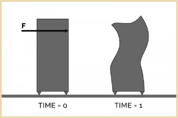

This goes against everything I've ever experienced, but here it is.
Does it make any sense to you?
Alsyvox
https://alsyvox.com/our-technology/
CONVENTIONAL LOUDSPEAKER ON SPIKES
No matter how rigid a box is it will vibrate at some frequency.
Stiff connection to the floor gives reflected waves in the frame.
DIPOLE LINE SOURCE ON SOFT LEVELERS
A distribution of small forces is less prone to excite frame vibrations.
Compliant (soft) connection to the floor does not give reflected waves in the frame.
Anything is possible in theory, but then you have to prove it with experiments, right?

Gary from Gensis covered some of this pretty well, how they work/don't with speakers.
But no, I think their information is simplified and incorrect.
I was talking to Daniele about this in the Alsyvox room last Munich.
He even sent me a quote for the feet for my Apogees.
TBH if I put my Duettas on spikes they sound better than just on the carpet sans spikes. But I am changing rooms and spikes probably won't be suitable so I may order the feet and see what happens.
So for the above post damping the frame appears to soften the sound and compromise bass tightness or definition. It sounds warmer, but not for the best.
So I am not sure I agree. He is right though it should and does calm the frame down.
At the end of the day it's best to just use what sounds best to you. I suspect using his feet is different again to letting medium pile carpet do the job.
Another issue is unwanted frame vibrations don't help a speaker. What I mean by that is both wanted and unwanted vibration will attempt to deconstruct your 'best made' speaker.
In other words, anything you can do to reduce overall levels of vibration may actually help to extend the life of the speaker.
Bolts can be a problem, for instance, and they have a tendency to want to undo themselves. It's very important to take countermeasures to avoid this sort of thing from happening.
