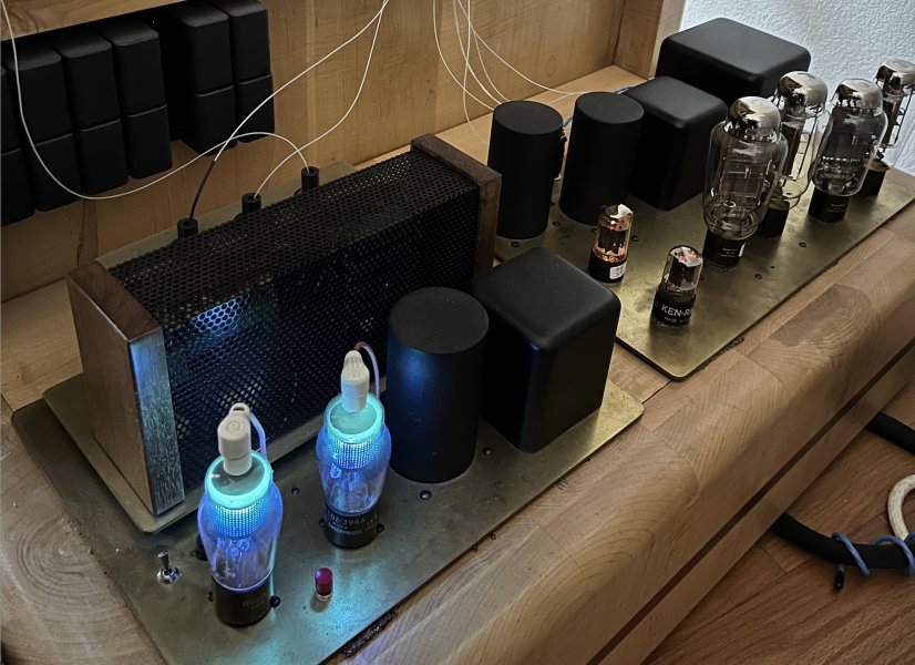

Hey,
JP is fighting the registration spam-bots so until he can respond and I will handle many of the technical questions in the meantime.
The speaker cabinets are made by a craftsman in Maryland to this specific project.
In the original '57 design a single amplifier drives an input transformer that steps the signal up to feed a high impedance passive crossover which directs the music to the appropriate panels.
JP's 57's use a line level crossover integrated into a pair of push pull 300B amps loaded with step-up transformers tailored to the panel frequency response. JP has added some additional subtle crossover shaping to the panels directly. One key aspect is the dual 300B amps reside in the base of the speaker to avoid the need to step down the voltage to drive speaker cables to then step it back up to drive the panels. In a typical situation the output of a 300B will see a 25:1 step-down to get to 'traditional' speaker level. This is then stepped back up by a factor of 70 for the highs and 280 for the bass to drive the electrostatic panels. This instance has a pair of 300Bs feeding a 1:2 output transformer to drive the HF panels and a second pair feeding a 1:8 to drive the bass panels.Screen Shot 2023-12-30 at 2.57.53 PM.jpgScreen Shot 2023-12-30 at 3.00.55 PM.jpg

Dave,
Did Bonzo report it accurately that you bypassed the use of the Acapella ION TW-S1 plasma super-tweeters’ internal PL-519 tube amplifiers in favor of your push-pull 300B to drive the modulator? Or are you simply just taking the high-level signal of the 300B amplifiers to drive the Acapella plasma tweeters’ internal PL-519 tube amplifiers?
I also cross my Acapella ION TW-1S plasma super-tweeters at 8.5KHz. I had the internal crossover upgraded in my units. The plasma super-tweeters add a lot to the sound and that is clearly evident when you switch them off.
the line level signal that drives the quad amps also drives a permalloy 50 amp that drives the speaker level inputs of the plasma.

Check out this site.
This guy upgrade plasmatweeter, important for the frequency is the quarzcell diameter bigger they work from 2.5khz as full tweeter in two way design. Only for infomation if you interested
Reactions: Carlos269
Great site and one of the best resources on plasma tweeters. Please keep in mind that the lower the crossover point the lower the efficiency of the Acapella plasma tweeter. In order to maximize their efficiency I use them at the highest recommended crossover point of 8.5KHz.
