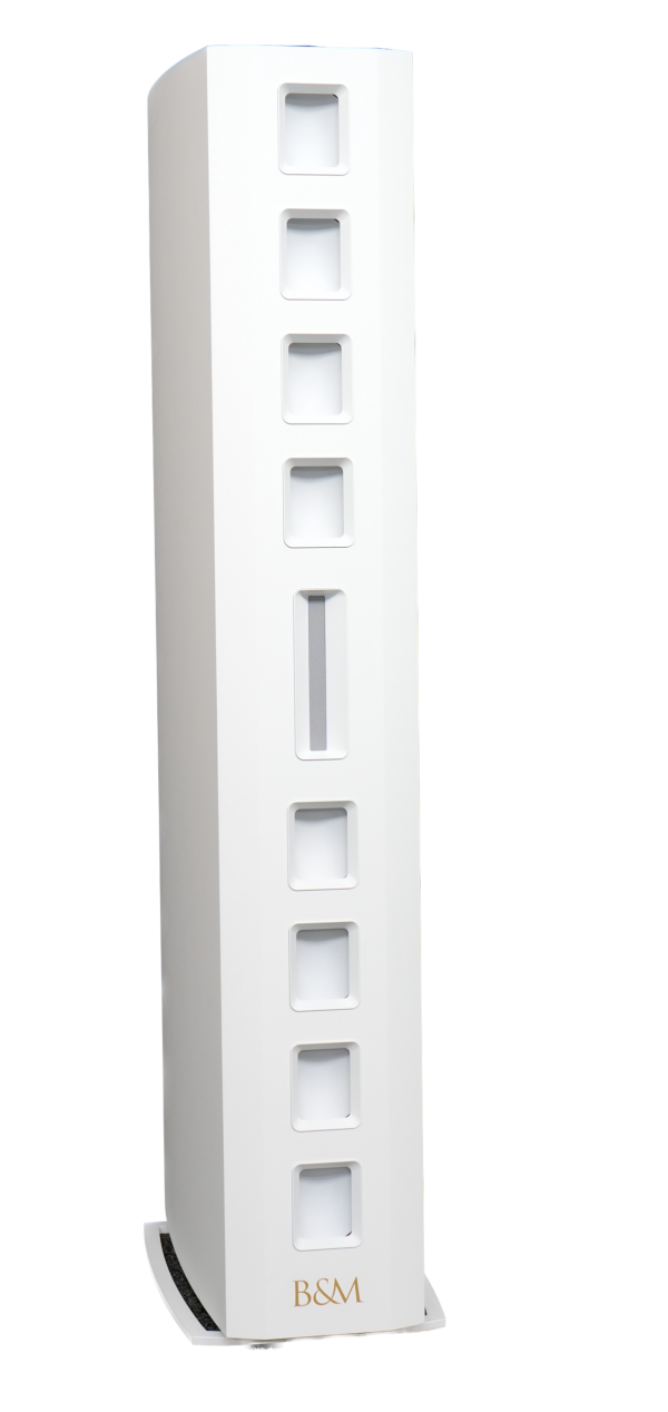

I did. They were featuring their BM Jubile, an interesting line array specifically designed to be living room friendly and mitigate room interaction. The sound was spacious, detailed and engaging in a relatively large room. Given the digital nature of their system they were using the excellent Thiel turntable and tonearm which I found interesting. RIAA done in the digital domain. All drivers are of their own design and manufacturer including two 12" woofers in the base that radiate energy from slots on the rear of the speaker, eight midrange drivers and a tweeter they refer to as Fraunhofer cylindrical wave radiators. Definitely different!

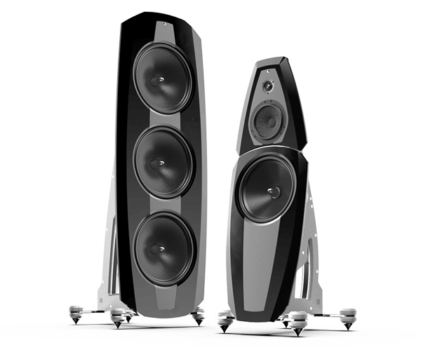

This was a big topic on www.audioreview.com as far back as 20 years ago. It really hasn’t changed although some high echelon guys like YG have tried. Magicos horn was active iirc. Most philes like to tinker and active just doesn’t allow for that.

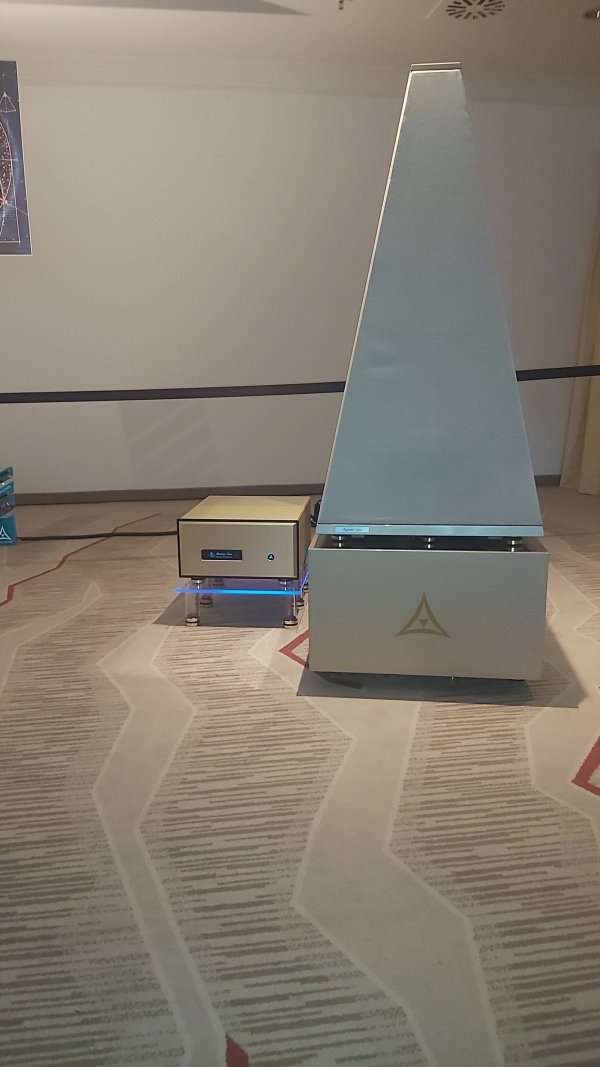

A few notable new products are Avantgarde's iTron active amplification, DEQX newest DSP tri-band active amp solution preamplifier and Airplain of Switzerland newly released speakers utilizing Puri-Fi internal amplifiers built into stainless steel enclosures and a companion pre-amplifier with a complete Weiss digital engine as an external front-end. Legacy's Wavelet system, and also Linn and Meridian system that have been at the forefront of digital amplification for over a decade.
