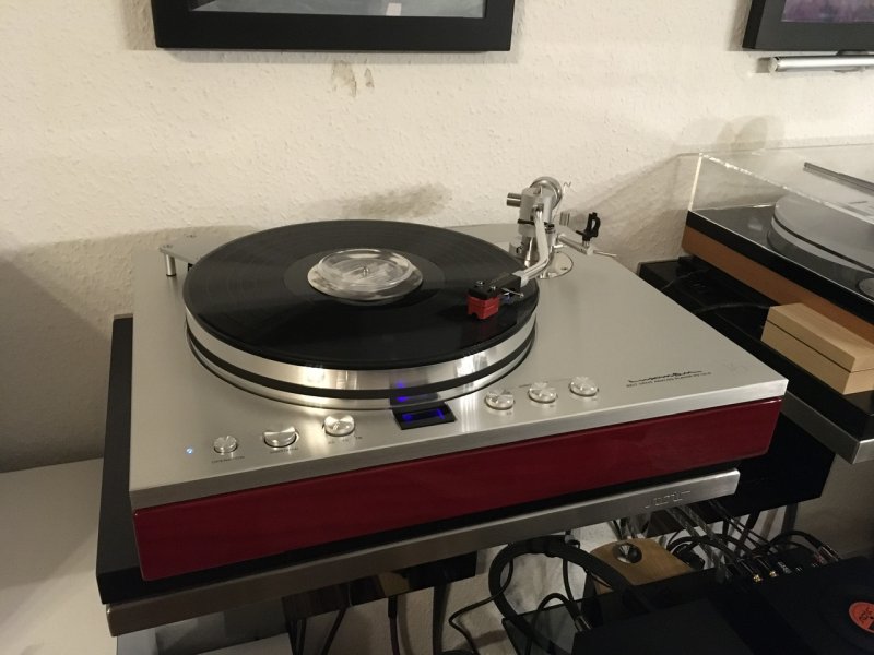

This week I had the opportunity to listen to the new PD-191A from Luxman in detail at home:
I'm in love...
atb, Tom
tony22
Nov 4, 2019
591
258
153
63
That's a pretty table! Is that their own arm?
Yes - the LTA-710 comes with the PD-191A and is developed by SAEC.

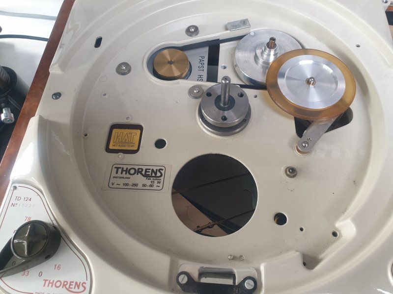

The funny thing is that most of the old Pabst motor where made for use with 2 phases and a capacitor, adding a 3 phase give you better adjustability of speed, torque and vibration. To run optimally at 33.3, 45 and 78 without changing pulleys different motor capacitors are needed, or you can do it with a adjustable 3 phase motor supply, :)
Yes the so called Steinmetz drive solution because turntables always were used on mains supply, vibration measurements shows the 100 hz (50hz drive ) vibration clearly.
With the 124 I use the mechanical speed change so no adjustment needed for the drive adjustment, small speed corrections are possible due stylus drag .
For a solution with one pulley diameter you need for every speed a optimal alignment for the phase shift circuit so 2 or three pcb needed not a easy solution but sound wise for me the preferred one analog not digital
I added an external power supply to my Transrotor Gold Classic turntable around 15 years ago. I did because chief engineer of Transrotor recommended it to me when I was visiting their room in Munich.
Actually old Papst motors in many turntables are 2 phase AC motors. Normally phase is 90 degrees between coils. One coil is fed directly with 24VAC other is fed via a capacitor (around 15uf). Which means there is actually 1 phase and the second phase is produced by a capacitor lag. When an external power supply is added there doesn’t need for a capacitor anymore because external power supply is a two channel amplifier. Since it’s an amplifier it turns AC supplied from the wall to DC and use transistors to amplify sinus waveform created by the oscillator. The benefit of this approach beyond clean sinus waveform is output voltage, phase and frequency can be precisely set. When you change the speed frequency of the waveform is changed by the oscillator. AC motors lock on frequency and speed can only be changed by frequency. Voltage is responsible from torque.
After adding external power supply I noticed a decrease in vibration, heat and noise on the my turntable’s motor and sound became more relaxed. Additionally power cord of the external power supply dramatically change the sound.
My Thorens TD124 Reference with Synchronous Papstmotor <not the Thorens asynchronous Papst> and Three phase powersupply .
I used to own a Thorens TD 124 for a while long time ago. AFAIK it’s motor is a 2 phase AC motor why do you need a 3 phase power supply?
Actually old Pabst motors in many turntables are 2 phase AC motors. Normally phase is 90 degrees between coils. One coil is fed directly with 24VAC other is fed via a capacitor (around 15uf). Which means there is actually 1 phase and the second phase is produced by a capacitor lag. When an external power supply is added there doesn’t need for a capacitor anymore because external power supply is a two channel amplifier. Since it’s an amplifier it turns AC supplied from the wall to DC and use transistors to amplify sinus waveform created by the oscillator. The benefit of this approach beyond clean sinus waveform is output voltage, phase and frequency can be precisely set. When you change the speed frequency of the waveform is changed by the oscillator.
The standard motor is the E50 a shaded pole motor which is a single phase motor.
Ok, but I did the upgrade to a Transrotor turntable which has a Papst motor similar to the one in the picture you shared. Actually when I checked the picture you shared on above post I can clearly see that it is a 2 phase motor from the writings over it. It is manufactured in April 1977 and if you want to run it direct from the wall you need to add a 0,5uf capacitor to delay the second phase. I can clearly see a red 0.47uf wima capacitor added to the circuit for this purpose which becomes redundant when 90 degrees two phase AC supplied by external power supply
I asked why 3 phase because almost always 3 phase motors come with external power supplies and we know that is not the case with Thorens TD124. I still wonder how a 3 phase power supply can be used with a 2 phase motor.
You may ask why 2 phase motor is used widely on turntables because it is easy to delay the second phase with a capacitor and it doesn’t have to be precise to drive the 90 degree 2 phase motor but 3 phase motors require precisely set 120 degree 3 phases and only a power supply can provide it from standard 1 phase AC household electricity.
