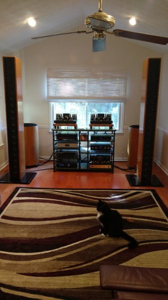

Hello everyone!
I just moved my system into a new room and am thinking about doing the wiring a bit different. I am thinking about having the equipment rack to the left of my listening chair that is behind the photo (minus the foot rest). I have the amps on the equipment rack right now but I think that will change as it looks like I will be getting a turntable again soon. The VAC Renaissance 70/70 has yet to be turned on in its location within the rack. Hopefully Kevin gives me the OK regarding the amp having enough room to breathe. Before it was on the floor in front of the rack, but my wife is not thrilled with that solution.
My wife also wants to put a christmas tree between the speakers so I am thinking about running a long run of speaker cables outside under the vinyl siding. Is this an absolutely terrible idea? Is there a type of cable that will not suck for this application? Ideally I would like this to be as clean looking as possible. Unfortunately I am on a slab so I cannot run wires through a crawl space, which would be better. I currently run Verastarr cabling which is short. All help is appreciated!

Doesn't look like there would be any great way to run the speaker cables. I think you'll have to make some compromises, as a very high quality speaker cable is expensive and long runs will be extremely expensive as the longer run the larger the gauge required as well.
If you're going to run cable outside and under the siding you'll want a machine-made cable, maybe some bulk Neotech speaker cable that uses UPOCC copper. It'll be pricey but maybe a good compromise of $ vs performance...

Depending on your circumstances and priorities an option would be to take off the base boards and then get a router and go deep enough so that you can get the cables (L,R,+,-) tucked in nicely. It can be done!
Alternately, you could build a little extension to your baseboards, creating a hollow space where you could hide the cables. Think crown molding at the floor level. Lots of profiles available you could easily find something that matches your current look.
Looking @ your picture; I'll leave things the way they are and put the Christmas tree @ another position in your home.
Your music is much more important than the Christmas tree; music is forever, Christmas only last one day...December 25. ...The tree? Two weeks max.

I recall a year or two ago, we had an international member who was on a slab and he chiselled through his stone/granite floor, making channels for the cables. He showed photos of it.
The idea of boxing out the baseboards will also give you the option to install stained hardwood moulding to match your beautiful floor. (Whose idea was white painted moulding next to that gorgeous wood floor anyway???)

So I brought up the idea of working with the molding / possibly doing some channels in the concrete slab. My wife laughed at me.. :p I think we are just going to move the rack to a side wall and do temporary wire channels. I'll figure it out after that. Pretty soon I'll be able to start doing measurements and treating the room. That should be fun!
If you are considering channels in the slab, verify 100% that you do not have a PTS ( post tension slab).
If you do, channels could be a deadly endeavor.
Do your research. On some homes there is identification of it in the garage floor, be very certain.
