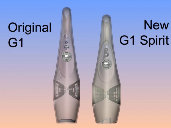

In my opinion the design has improved.
The crossover has been in fact completely revised and is no longer inside the cabinet but stands in its dedicated carbon fiber enclosure. The new crossover topologies are implemented with new components exhibiting improved thermal tracking. Dickie have used only high quality 99.9% OFC copper air cored inductors (no iron cored inductors are used there, as they could lead to saturated sound issues). High grade polypropylene capacitors, Van den Hul hand point to point quality wiring (soldered directly into the circuit) and high quality silver containing solider are also used throughout. Whilst being quite similar to the regular G1 filter, following the same fourth order Linkwitz-Riley design, the new crossover has a tighter tolerance due to the new C225/100 and C125/75 carbon.
Having the crossover outside the cabinet, two extra layers of CNC machined carbon skinned composite braces have been added in the G1S' basement, making the cabinet even stiffer. Let's remind that the original Giya speakers were made of a balsa-cored composite sandwiched between layers of quadraxial glass fiber. A specific vacuum infusion process got resin applied on the whole structure which was reinforced by ten fiberglass grids placed laterally every six inches inside the regular G1.
According Philip Guttentag, these new carbon braces are lighter in mass and fit much better into the curved internal cabinet shape of the Spirit compared to the former fibre glass braces of the G1. These new braces are now directly made in house (whilst the former fibre glass grids were manufactured in China). Philip Guttentag also told me that he has been impressed by the impact of the new enclosure on the overall sonic result. "When one is using decoupled low distortion drive units, the cabinet becomes so much more of an important component in the acoustic performance of the speaker".
In fact, the enclosure looks slightly different compared to my regular Giya G1. Knocking on the cabinet, the former G1 sounded like a kind of "light dead weight". With the Spirit, you still have this sensation of a complete inertia and lack of resonance but it sounds even more stiffer and heavier than the regular G1. This is a real achievement as the previous stiffness-to-mass ratio was already rather elevated, if not unequalled in the market of high-end loudspeakers.
The position of the centre of gravity seems to be lower and the new enclosures looks definitely more stable on my wood floor meanwhile it's quite mandatory to adjust the rubber feet of my own G1 pair very precisely to make it completely stable. Subsequently, the new G1 Spirit seem more connected to the ground and this might impact their setting in your room compared to the regular G1s.
I have declared two years ago that, in my opinion, the Vivid Audio G1 had the purest shape of the whole Giya line, and that the smaller versions were somehow a scale compromise.
Today, I still confirm my thoughts about the shape of the regular G1 compared to its younger sisters. The original G1 still looks as a beautiful sculpture, a true piece of art, in the same way of the older Nautilus. But the new Spirit looks more like the result of a golden section's design. The purity of its line made me think about a frozen water drop.
The tapered tubes of the dome drivers (D26k and D50k) have also been redesigned to achieve a one-piece moulded absorber transmission line. Compared to the previous version, they are lower in mass and subsequently store less energy resulting in better attenuation of the standing waves.
The way it works remains nevertheless the same: a tapered hole in the centre of the pole piece smoothly couples the diaphragm to a fibre damped, exponentially tapered tube. This tube acts as an ideal enclosure, being completely free of resonance or reflection. The exponentially tapered tube behaves pretty much like a straight tube but occupies about a third of the volume. When adding the damping material, naturally compressed by the tube’s narrow end, it has resulted in a performance which actually exceeded that of a parallel tube.
