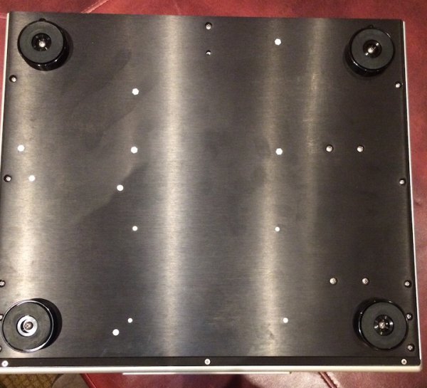

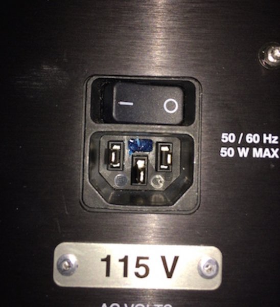

Thank you for responding so promptly to my post. Here is a pic of the AC connector/putative fuse holder. I have no idea what that blue thing is between the top prongs but whatever it is, it doesn't look like something that can be removed. I'm reluctant to push it in for obvious reasons. That may mean the fuse is internal. IF so, here a pic of the bottom panel. Do either of you have a clue as to which screws I should remove to open the unit?
I just love hi end gear,
Marty
Definitely no visible fuses on the IEC connector or anywhere on the back of the unit that I can see from online pictures. The power supply is switchmode and fully encapsulated:
If there is a fuse it would be inside that long box. Be very careful please. You have 340 volt DC voltage hanging around there potentially. It could be quite lethal.
And yes, the fuse may be a surface mount device that while easily sourced, won't be easy to find and replace.
Thanks Amir,
Any idea what that blue thing is between the AC prongs?
From what you are showing me, I'm not in love with the Meitner folks, at least not today. I hope I can get this thing serviced by someone closer to me rather than send it back to EMMlabs.
Marty
I don't know Marty. The fused IEC connectors that are fused have a fuse symbol on them.
