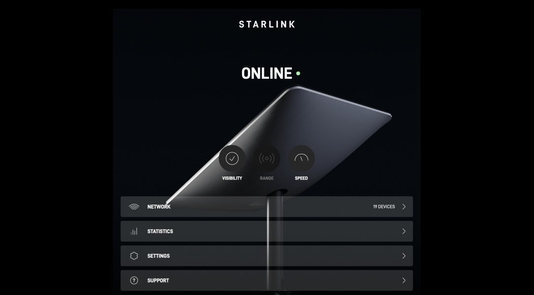

I meant to bring this up earlier but forgot -- when I was reading the Taiko router instructions it struck me that the IP address -- 192.168.100.1 -- is also the IP address StarLink uses for accessing their router's control panel (though the network address of the StarLink router is 192.168.1.1, as shown by LanScan)
As a first thought I'm thinking that for my situation I might need to temporarily turn off my StarLink router while I access and set up my Taiko router, including changing the Taiko router IP address. After the Taiko router address is changed there should be no conflict with accessing the StarLink router controls. Comments?
SteveZ
Steve, that seems like the right approach. Once you can access your Taiko router and change the IP address you should be fine.

Oh dear, 192.168.100.1 is quite commonly used by modems. My Netgear CM-600 cable modem uses it as well. In such cases, you'll probably want to configure the Taiko router to use a different subnet.
If it were me, I would do what I always do with any new router: connect a desktop or laptop to it via wired Ethernet, making sure I am disconnected from my home network. This machine will get a DHCP address from the Taiko router. Then in a browser, login to the Taiko router's admin web UI and reconfigure it appropriately, per the Taiko router manual.
Indeed, that is my plan when I receive my router and DCD.
