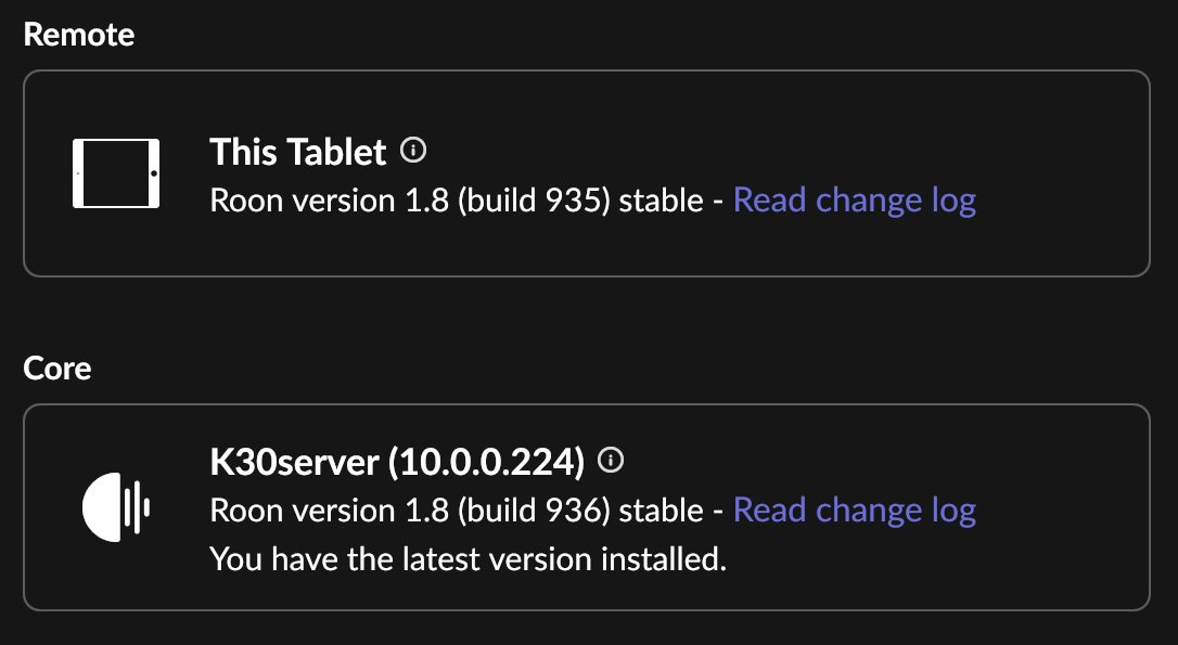

Every 1-2 days it won’t play tracks. It runs through a track really quickly as if it’s playing it, but it doesn’t connect to the DAC. Restarting the Extreme does it. I suppose I could try quitting Roon and reloading it as well; but I just use VNC to restart the machine.
Not really a big deal since I won’t use Roon once XDMS arrives…
That's strange that it is intermittent? Regardless where you wind up it shouldn't be doing that. Maybe uninstall and then reinstall Roon?
@Surge1 Check and make sure your Roon Remote is the same 'Build Number' as the Core.
That could be it, which would explain intermittent.
Thanks. They are not the same build number! The Remote is 1.8 (935) and the Core is 1.8 (936). It’s not prompting an update so not sure how to force the Remote to update?
I have the same versions. I suspect a 936 for tablet is forthcoming.
I also have the same versions, so this, I don't think, is the problem you are having with Roon.
