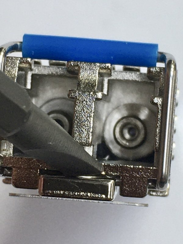

Have any of you folks tried to remove an SFP (Planet MGB-TLX in my case) from the optical port on the Extreme? Any luck?
I find the orientation of the internal board/cage to be such that inserting the SFP leaves it very "tight" to one side of the casework.
The net result of which is you cannot open the bail to pull out the transceiver. The bail position controls the small tab which secures the device into the receiver cage...and allows removal.
Am I missing some key action for SFP removal? I realized it was a tight fit when inserting the SFP, but it did not occur to me it would be so tight, that I would be unable to open the bail for removal.
Any solutions in the crowd? Thank you...

Regarding SFP removal, the orientation of the SFP cage relative to the heat-sink fins, means you cannot open the bail to remove the transceiver, as noted previously.
It was also noted you could remove the SFP if you removed the optical card inside the Extreme.
The purpose of the bail is to facilitate a better and uniform grip on the SFP for removal *and* to provide leverage to lift a small tab that snaps/locks the transceiver into the cage. The satisfying "click" you hear when properly seated.
It is also possible to use a small screwdriver to lift the tab, thereby releasing the "lock" mechanism.
You can then grasp the SFP and pull it out, per usual. A little finicky, perhaps, but easier than a complete card removal. Probably safer too.
Note: the color and shape of the wire bails are not uniform across brands/types, but the same concept was used over the three brands and two types I evaluated. I believe this is the standard structure of these devices.
