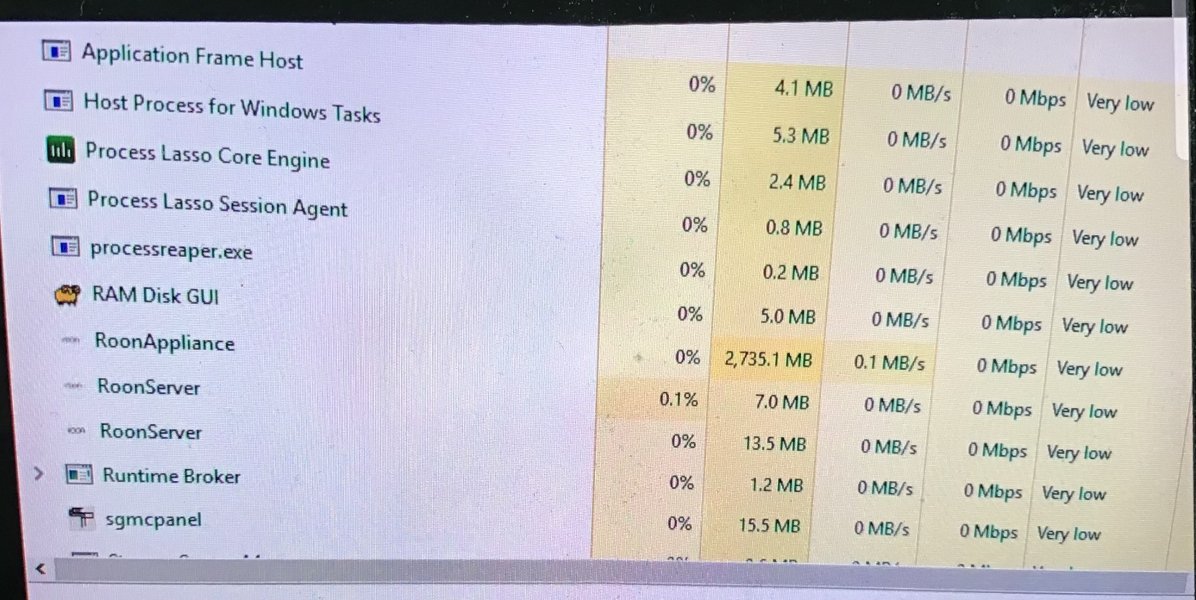

NO! When you toggle between the 2, when you go back to Roon NO AUDIO DEVICE FOUND and it flashes back and forth, it find it for a split second, then it can't...
I know the reason.
you have 2 roon servers aplications running. I had the same symptoms.
solution for short time:
stop one of the roon server in the manager
