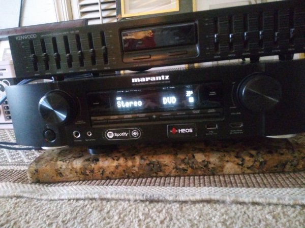

If you are going that route.SOTA is a matter for doscission.
A Marantz receiver has 7.2 with dedicated stereo mode. That means you get side channels and 2 subs.
