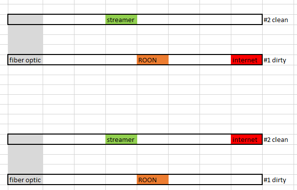

Hey @orange55 ... want to try something?
I think you have 2x SOtM switches and you can check this one out (as I also have 2x SOtM). Let's say #1 is the one in which you plug the rest of the network (or router) and then, by fiber optic you reach the #2 from which is the output to the streamer.
I don't know if you own a Roon server / Roon ROCK, but in my case I tried to plug that ROCK in #1 just to keep the #2 as calm as possible.
But ... wait a minute here ...
If I plug the router / rest of the network in #2 and the Roon server in #1 ... then the internet/network signal will pass twice through the fiber optic, cleaning more noise.
E.g.
@valicu2000 Thanks for the feedback. Good idea.
I don’t run Roon, I have a Melco server which has its only filtering built in. This gives me a third layer of filtering, but it is a pass through, plus I stream Qobuz direct to the streamer, so I can’t root the signal as you have. But a great idea.

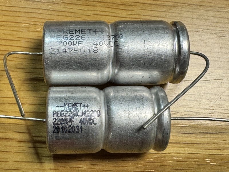

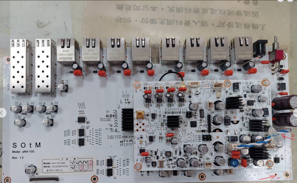

I'm wondering if it's safe to add a 3300uF 25V-50V polarized capacitor ( Nichicon Fine Gold ) to the free spot (the upgraded switch has a Kemett 2700uF 40V capacitor in there):
Its a 2200uf/40v Evox RIfa / Kemet.
I tried a 2700uf/40v Kemet but it didn't sound as good as the 2200uf. From memory, which may be flawed, the 2700uf gave me bloated bass.
3300uf should be safe to try.
Good luck! Let us know if the Nichicon FG works out great for you.

Thank you @AngeloVRA !
For the moment there isn't any capacitor installed in that switch, I don't think it will sound worse with a 3300uF Nichicon + replaced internal power cable.
