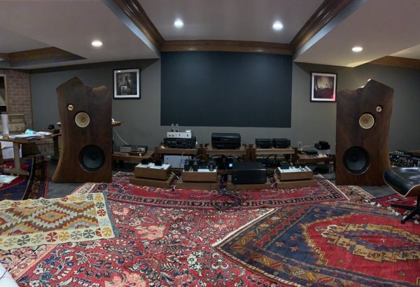

Can you post some pictures of your setup?

I am travelling today but will send some photos when I'm home tonight or tomorrow.

Wow, looks like a fantastic setup! The workman ship on the speakers is stunning.
Is Treehaus Audiolab a company?
The power supply looks neat. Are there dials to control the voltage/current?
Thanks, sorry the photos weren't great--I had trouble uploading a couple others for some reason.

I’d love to see the rest of your system. The speakers and the power supplies look fantastic.

Thanks for the information on your speakers Jay! The photos look great, but I would love to see some shots from a distance.

Here are some system shots as requested:
BF9D59D3-9A3B-4D09-99FE-CAE6CC05569A_1_105_c.jpegFD155830-67EB-4E01-BA37-A246F2957A0C_1_105_c.jpeg35B04C19-CC88-4E97-8D49-AA89BCDB5B71_1_105_c.jpeg7E694855-1C11-4B5F-8BE5-5B9560B832CB_1_105_c.jpeg60DDF25C-E564-4F3B-9088-B7C333B397E9_1_105_c.jpeg974EF7A8-CA14-404A-A39C-753292D77F14_1_105_c.jpeg1FF97296-309E-4A16-9F0B-8482CDBC84B9_1_105_c.jpegE5BF6306-0E55-4BDE-B007-40003657E162_1_105_c.jpeg5B2BE68C-A5D1-4AD9-8F23-F6EEAA0A1607_1_105_c.jpeg
Hi Jay,
Thanks for your reply. I love the pics. I like the way they have used solid timber for the speaker baffle. I also love the look of your roo, it looks big and really solid.
